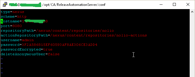

    We've checked that the management server reaches the 8080 port on the repository server  and the nolio-repo.properties file is correctly set as per instructed by the documentation.  With hostname set with the repository's IP address:
    Are we missing something here? Do we need to configure something else in Nexus? if so, what is that?
