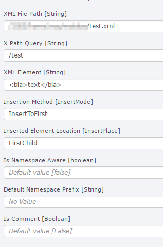

    I'm trying to do two XML Element inserts in a row.
    First shall insert as "First Child", second shall insert as "After First Child".
    The result does not meet my expectations. See below for screenshots and explanation.
    test.xml:
    First Action
    Result:
    Looks fine so far. Element <bla> is inserted as First Child element.

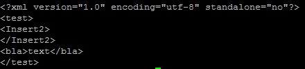

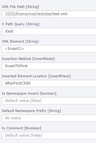

    Second Action:
    XML element contains a Line Break in this case:
    <Insert2>
    </Insert2>
    Result2:
    This is where I'm having a different expectation.
    After the first action the "First Child" element is "<bla>".
    So inserting "After First Child" should insert <Insert2> after (below) element <bla>.
    My Expectation would be this result:
    Do I get somehting wrong here or is this not working as it should?

    Hi Max
    To me it looks like this is not working as expected , i did do a quick test and got the same result when
    there is only 1 child , if you have two childs it works fine.
    A workaround for this could be to use the lastchild option .
    Any way i would suggest to raise a support case
