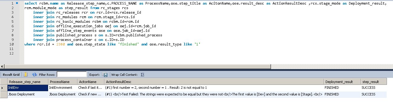

Try use this query (I use MySQL DB)
It will list the failed actions for specific release id
select rcbm.name as Releaase_step_name,c.PROCESS_NAME as ProcessName,ose.step_title as AcitonName,ose.result_desc as ActionResultDesc ,rcs.stage_mode as Deployment_result,
rcm.module_mode as step_result from rc_stages rcs
inner join rc_releases rcr on rcr.id=rcs.release_id
inner join rc_modules rcm on rcm.stage_id=rcs.id
inner join rc_basic_modules rcbm on rcbm.id=rcm.id
inner join offline_execution_jobs oej on oej.id=rcm.job_id
inner join offline_step_events ose on ose.job_id=oej.id
inner join published_process s on s.ID=rcbm.published_process
inner join process_container c on c.ID=s.ID
where rcr.id = 2380 and ose.step_state like 'finished' and ose.result_type like '1'
