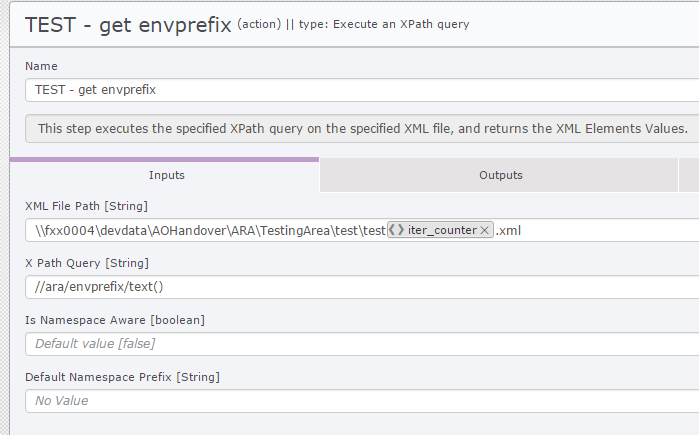

    for the flow I have the following:

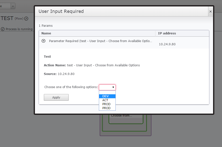

    As you see, in the end I have the entry of test3.xml twice in my result, which means that the xpath action doesn't reset it's result when it doesn't find anything.
    best regards
    michael
