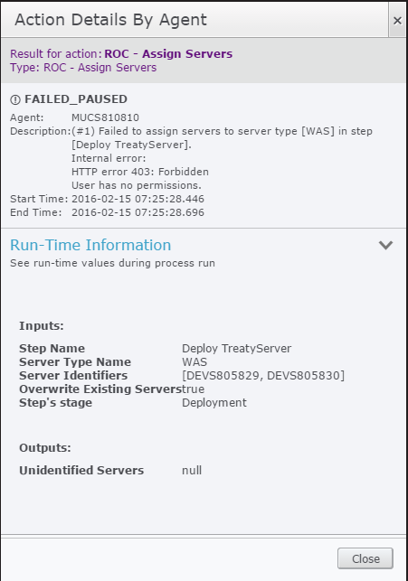

    I tried it again with a testuser, which I gave the permissions:
    - Can View Application
    - Can View Design Components
    - Can View Execution Components
    - Release Template Designer
    - Release Designer
    - Can Execute All Processes
    - Can Execute All Releases
    When creating the deployment I check the "assign all servers" checkbox (we need this, as we also have server types where all environment servers are included and that are used for general flows)
    the error I'm getting directly points to missing permissions:
    although the servers are assigned to the environment:
    As I said, when I'm giving the testuser environment admin rights, everything works.
    We're currently running on ROC Version 5.5.2.191
    Do you know of any fixes or changes with this action in your version?
    Thanks.
    best regards
    Michael
  • 6.  Re: ROC - Assign Servers - environment admin needed?
    Best Answer
    Posted Feb 15, 2016 02:07 AM
    I checked 5.5.2-324 fix README file and found the following description:
    "- Fix requirement to be env-admin to be able to assign servers to server type"
    I think this exactly the problem you are facing
    Thanks
    Jacky
