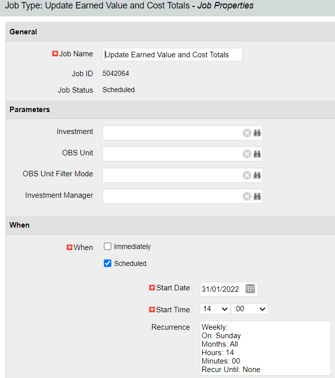

    I'm assuming that the job you mean is the Update Earned Value and Cost Totals job, but that's a detail. In my system that has an internal Job ID of 5000046. Here is what I did.
    1) Created a scheduled job for that job with no end date that runs on Sundays, with a start date in the future:
    This scheduled job has an internal ID of 5042064.
    2) Next I created a job process on the project object using the script you attached as the base, but with some minor changes. The main ones are the Job ID is picked up from a parameter and the Project ID is determined at run time, rather than hard-coding them. I've attached the script to this reply.

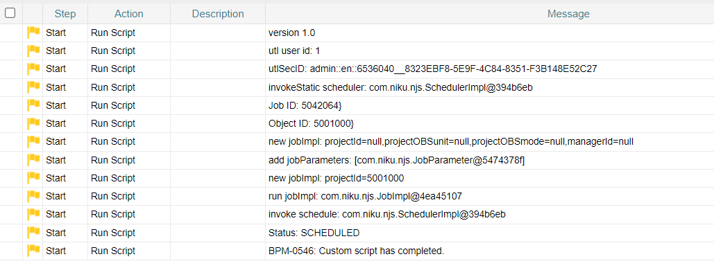

    3) I opened the project, navigated to the processes tab and executed the process. The log looks like this:
    Which suggests the process has scheduled the job.

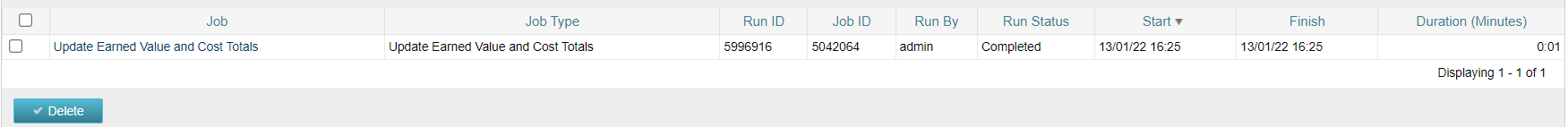

    4) I went into the Scheduled Job and navigated to the instances that have been executed and it looks like the job ran OK:
    Is that what you need, or have I misunderstood?

    Could you please confirm if the Job is picking that particular project instance or running for all? Even before the job is running for me but not picking particular Project/Idea.
  • 8.  RE: How to run parametrized Job through a process?
    Posted 13 days ago
    Apologies for not checking that. The job is being run with the parameters all blank, and hence for all projects as you say. I'll take another look. Just one more question though... Is the intention to generalise the script so that it calls the job for several projects, or is the number of projects (or ideas) very small and the ones it needs to run for are known in advance?

    I've posted my findings twice on this thread but they don't seem to stick.
    I'll try again without the code.
    Basically I set up all four parameters (the last 3 being null) and then echoed the parameters back again after oulling them back again as in the original code.
    They are all blank so I think that setting the parameters doesn't work as expected.
