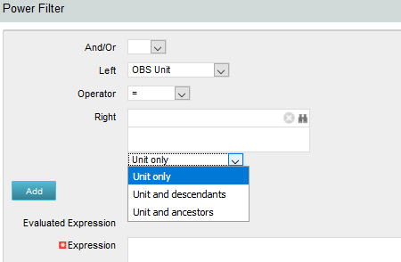

    is it possible to have the OBS Mode field appearing, when the Parameter OBS is selected in the Power Filter on a custom portlet?
    I see this behaviour on objects, like project (and also custom objects):
    --> "unit only" etc. is popping up after select "OBS Unit" in the dropdown

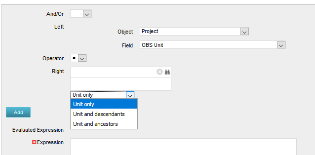

    also on custom objects:

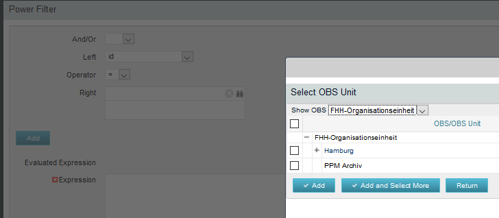

    But on a custom portlet it will not appear, even if the attribute is linked with OBS:
    note: id is linked to the OBS in the Query, so you can select an OBS Unit into the Right-Field. But there is no dropdown appearing below to select the Unit Mode.
    Isn't this possible on Portlets? Or how can I achieve this?

    thanks. But I guess your code provided is, to achieve it, to make both OBS fields available in the normal filter.
    This I already have.
    I was wondering, why the dropdown field "OBS mode" is not appearing in the Power Filter of a custom portlet, when I choose the OBS as the first attribute.
    As you see in the original post. The first 2 screenshots are made from objects. The third screenshot is from a portlet Power filter (where "id" is linked to the OBS)
