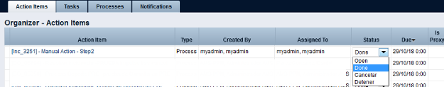

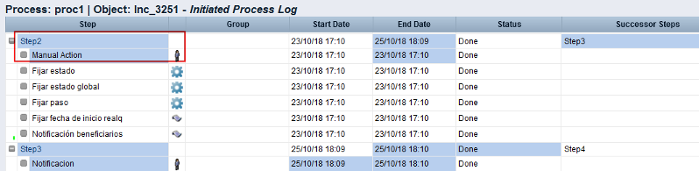

    In Clarity 14.2,  and just for an specific process and step, after answering a manual action, in Organizer the action keeps the answered value (Done, Cancel,...)  when it should be "Closed".
    However, the Action item answer was processed properly by a post condition and the process moved forward, and curiously later manual action will take the vale "Closed" after the process moves to a next step.
    Process log
    Organizer action not closed
    Organizer - later action is closed

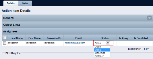

    Action item details
    The action item message has active the option "Make Action Item available to other Steps"

    Checking at database.
    CAL_ACTION_ITEM_ASSIGNEES.STATUS_CODE="DONE"
    where it should have the value "CAL_CLOSED"

    Hi Daniel,
    This is the expected behavior when you have the option "Make Action Available to Other Steps" selected.
    When it is not selected, the action item will close when the process moves to the next step.
    When you select this option, the action item will not be closed until the process is completed.  This way if you want to base a condition in a later step on the user response to this action item, the response can be seen by the other steps.
