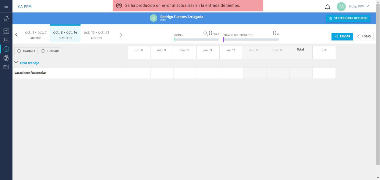

    The new UX is having problems when users enter time in the timesheets.
    The visible error is:
    The error message in the app log is:
    Illegal instant due to time zone offset transition (America/Santiago)
    This only happened with time entries belonging to the last week (from "08-OCT-2018" to "14-OCT-2018").
    No problems detected in previous and further weeks.
    Any ideas?
