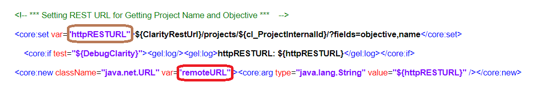

    I see that tha article is only for self-consuming the CA PPM RESTful WebServices.
    Could you provide a general guideline for adapting this to an external RESTful WebService ?
    Is as simple as changing the httpRESTURL  / remoteURL ?
    Or do you need more variables to take into consideration?

    You just need to change httpRESTURL value and it will work for external web services as well. Try hard coding the url and then set property accordingly. let me know if you need any help with that.
