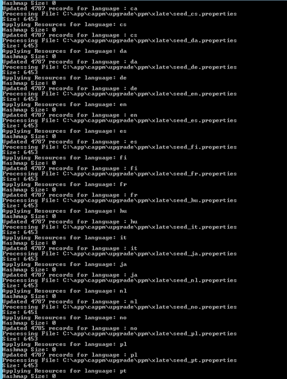

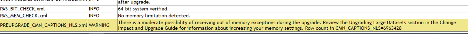

    I m trying to upgrade ppm from 14.2 to 15.3. I have a warning in my checkInstall Results that I shared below.
    Although I have this warning, I have started to upgrade ,however, this part almost took 12 hours and it still continue. I think it is related to this warning. Do you have any idea how to solve this.

    The warning can be ignored. Generally upgrade do take time and it depends on the size of the database. What is the size of the database you have.

    12 hours for 14 GB database is long, it looks like the upgrade might have been hung. Do you see the install logs rotating or any activity at the database.

    I did not notice somethig weird. I shared checkinstall result. May these warnings cause this slowness.

    Going by the experience with having well tuned DB this shouldn't have taken longer but its best practice to delete the process instance regularly. Did you check at DB side where it was stuck?
