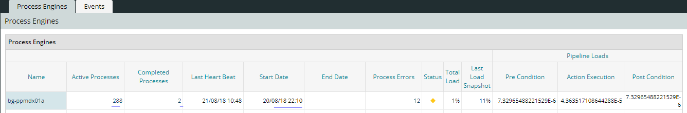

    Hi guys!!
    After the upgrade 14.4 to 15.1, the service bg doesn't work.
    We have 1200 running process in BG and the total 1400 process.
    I created a simple processes with no linked object, but  doesn't  start.
    Yesterday the process performed in 6 hours.

    Error bg-ca.log:
    SYS   2018-08-21 13:07:11,073 [Thread-6] njs.SchedulerImpl (clarity:none:none:none) PPM 15.1.0.149 Job Scheduler bg@ppmdx01a initializing... SYS   2018-08-21 13:07:11,073 [Thread-6] njs.SchedulerImpl (clarity:none:none:none) PPM 15.1.0.149 Job Scheduler bg@ppmdx01a initializing... SYS   2018-08-21 13:07:11,580 [Thread-6] njs.SchedulerImpl (clarity:SCHEDULER:44806040__403501EE-F84D-4C88-8689-97C021FBE4DC:none) PPM 15.1.0.149 Job Scheduler bg@ppmdx01a initialized SYS   2018-08-21 13:07:11,580 [Thread-6] njs.SchedulerImpl (clarity:SCHEDULER:44806040__403501EE-F84D-4C88-8689-97C021FBE4DC:none) PPM 15.1.0.149 Job Scheduler bg@ppmdx01a initialized WARN  2018-08-21 13:08:17,851 [Process Loader (tenant=clarity)] object.ODFAbstractObjectImpl (clarity:PROCESS_ADMIN:44806039__47134571-5F3A-43A6-BC47-9E2DF24009AF:none) Read of object: oi_fase_contratada instance ID: 6082092 returned: 0 rows WARN  2018-08-21 13:08:17,851 [Process Loader (tenant=clarity)] object.ODFAbstractObjectImpl (clarity:PROCESS_ADMIN:44806039__47134571-5F3A-43A6-BC47-9E2DF24009AF:none) Read of object: oi_fase_contratada instance ID: 6082092 returned: 0 rows ERROR 2018-08-21 13:08:18,070 [Process Loader (tenant=clarity)] statemgmt.RuntimeObject (clarity:PROCESS_ADMIN:44806039__47134571-5F3A-43A6-BC47-9E2DF24009AF:none) ----> RuntimeObject.refreshObject - Object not bound to an instance: com.niku.bpm.engine.statemgmt.RuntimeObject@3155f5c4 Process Instance Id: 8418690 Step Instance Id: -1 Src Step Instance Id: -1 Partition Code: NIKU.ROOT Object Name: prop Object Type: oi_proposta Object Id: -1 Is System: false Parent Object: com.niku.bpm.engine.statemgmt.RuntimeObject@6c69e772 Process Instance Id: 8418690 Step Instance Id: -1 Src Step Instance Id: -1 Partition Code: oi_ti Object Name: thisFase Contratada Object Type: oi_fase_contratada Object Id: 6082092 Is System: false Parent Object: null]] ERROR 2018-08-21 13:08:18,070 [Process Loader (tenant=clarity)] statemgmt.RuntimeObject (clarity:PROCESS_ADMIN:44806039__47134571-5F3A-43A6-BC47-9E2DF24009AF:none) ----> RuntimeObject.refreshObject - Object not bound to an instance: com.niku.bpm.engine.statemgmt.RuntimeObject@3155f5c4 Process Instance Id: 8418690 Step Instance Id: -1 Src Step Instance Id: -1 Partition Code: NIKU.ROOT Object Name: prop Object Type: oi_proposta Object Id: -1 Is System: false Parent Object: com.niku.bpm.engine.statemgmt.RuntimeObject@6c69e772 Process Instance Id: 8418690 Step Instance Id: -1 Src Step Instance Id: -1 Partition Code: oi_ti Object Name: thisFase Contratada Object Type: oi_fase_contratada Object Id: 6082092 Is System: false Parent Object: null]] WARN  2018-08-21 13:08:18,385 [Process Loader (tenant=clarity)] object.ODFAbstractObjectImpl (clarity:PROCESS_ADMIN:44806039__47134571-5F3A-43A6-BC47-9E2DF24009AF:none) Read of object: oi_fase_contratada instance ID: 6082041 returned: 0 rows WARN  2018-08-21 13:08:18,385 [Process Loader (tenant=clarity)] object.ODFAbstractObjectImpl (clarity:PROCESS_ADMIN:44806039__47134571-5F3A-43A6-BC47-9E2DF24009AF:none) Read of object: oi_fase_contratada instance ID: 6082041 returned: 0 rows ERROR 2018-08-21 13:08:18,401 [Process Loader (tenant=clarity)] statemgmt.RuntimeObject (clarity:PROCESS_ADMIN:44806039__47134571-5F3A-43A6-BC47-9E2DF24009AF:none) ----> RuntimeObject.refreshObject - Object not bound to an instance: com.niku.bpm.engine.statemgmt.RuntimeObject@60461b8c Process Instance Id: 8412881 Step Instance Id: -1 Src Step Instance Id: -1 Partition Code: NIKU.ROOT Object Name: prop Object Type: oi_proposta Object Id: -1 Is System: false Parent Object: com.niku.bpm.engine.statemgmt.RuntimeObject@5c39dda4 Process Instance Id: 8412881 Step Instance Id: -1 Src Step Instance Id: -1 Partition Code: oi_ti Object Name: thisFase Contratada Object Type: oi_fase_contratada Object Id: 6082041 Is System: false Parent Object: null]] ERROR 2018-08-21 13:08:18,401 [Process Loader (tenant=clarity)] statemgmt.RuntimeObject (clarity:PROCESS_ADMIN:44806039__47134571-5F3A-43A6-BC47-9E2DF24009AF:none) ----> RuntimeObject.refreshObject - Object not bound to an instance: com.niku.bpm.engine.statemgmt.RuntimeObject@60461b8c Process Instance Id: 8412881 Step Instance Id: -1 Src Step Instance Id: -1 Partition Code: NIKU.ROOT Object Name: prop Object Type: oi_proposta Object Id: -1 Is System: false Parent Object: com.niku.bpm.engine.statemgmt.RuntimeObject@5c39dda4 Process Instance Id: 8412881 Step Instance Id: -1 Src Step Instance Id: -1 Partition Code: oi_ti Object Name: thisFase Contratada Object Type: oi_fase_contratada Object Id: 6082041 Is System: false Parent Object: null]] WARN  2018-08-21 13:08:18,785 [Process Loader (tenant=clarity)] object.ODFAbstractObjectImpl (clarity:PROCESS_ADMIN:44806039__47134571-5F3A-43A6-BC47-9E2DF24009AF:none) Read of object: oi_fase_contratada instance ID: 6081040 returned: 0 rows WARN  2018-08-21 13:08:18,785 [Process Loader (tenant=clarity)] object.ODFAbstractObjectImpl (clarity:PROCESS_ADMIN:44806039__47134571-5F3A-43A6-BC47-9E2DF24009AF:none) Read of object: oi_fase_contratada instance ID: 6081040 returned: 0 rows ERROR 2018-08-21 13:08:18,790 [Process Loader (tenant=clarity)] statemgmt.RuntimeObject (clarity:PROCESS_ADMIN:44806039__47134571-5F3A-43A6-BC47-9E2DF24009AF:none) ----> RuntimeObject.refreshObject - Object not bound to an instance: com.niku.bpm.engine.statemgmt.RuntimeObject@5a42059d Process Instance Id: 8414226 Step Instance Id: -1 Src Step Instance Id: -1 Partition Code: NIKU.ROOT Object Name: prop Object Type: oi_proposta Object Id: -1 Is System: false Parent Object: com.niku.bpm.engine.statemgmt.RuntimeObject@607473ce Process Instance Id: 8414226 Step Instance Id: -1 Src Step Instance Id: -1 Partition Code: oi_ti Object Name: thisFase Contratada Object Type: oi_fase_contratada Object Id: 6081040 Is System: false Parent Object: null]] ERROR 2018-08-21 13:08:18,790 [Process Loader (tenant=clarity)] statemgmt.RuntimeObject (clarity:PROCESS_ADMIN:44806039__47134571-5F3A-43A6-BC47-9E2DF24009AF:none) ----> RuntimeObject.refreshObject - Object not bound to an instance: com.niku.bpm.engine.statemgmt.RuntimeObject@5a42059d Process Instance Id: 8414226 Step Instance Id: -1 Src Step Instance Id: -1 Partition Code: NIKU.ROOT Object Name: prop Object Type: oi_proposta Object Id: -1 Is System: false Parent Object: com.niku.bpm.engine.statemgmt.RuntimeObject@607473ce Process Instance Id: 8414226 Step Instance Id: -1 Src Step Instance Id: -1 Partition Code: oi_ti Object Name: thisFase Contratada Object Type: oi_fase_contratada Object Id: 6081040 Is System: false Parent Object: null]] WARN  2018-08-21 13:08:23,494 [Process Loader (tenant=clarity)] object.ODFAbstractObjectImpl (clarity:PROCESS_ADMIN:44806039__47134571-5F3A-43A6-BC47-9E2DF24009AF:none) Read of object: oi_fase_contratada instance ID: 6093030 returned: 0 rows WARN  2018-08-21 13:08:23,494 [Process Loader (tenant=clarity)] object.ODFAbstractObjectImpl (clarity:PROCESS_ADMIN:44806039__47134571-5F3A-43A6-BC47-9E2DF24009AF:none) Read of object: oi_fase_contratada instance ID: 6093030 returned: 0 rows ERROR 2018-08-21 13:08:23,501 [Process Loader (tenant=clarity)] statemgmt.RuntimeObject (clarity:PROCESS_ADMIN:44806039__47134571-5F3A-43A6-BC47-9E2DF24009AF:none) ----> RuntimeObject.refreshObject - Object not bound to an instance: com.niku.bpm.engine.statemgmt.RuntimeObject@539625f4 Process Instance Id: 8432736 Step Instance Id: -1 Src Step Instance Id: -1 Partition Code: NIKU.ROOT Object Name: prop Object Type: oi_proposta Object Id: -1 Is System: false Parent Object: com.niku.bpm.engine.statemgmt.RuntimeObject@32fc091c Process Instance Id: 8432736 Step Instance Id: -1 Src Step Instance Id: -1 Partition Code: oi_ti Object Name: thisFase Contratada Object Type: oi_fase_contratada Object Id: 6093030 Is System: false Parent Object: null]] ERROR 2018-08-21 13:08:23,501 [Process Loader (tenant=clarity)] statemgmt.RuntimeObject (clarity:PROCESS_ADMIN:44806039__47134571-5F3A-43A6-BC47-9E2DF24009AF:none) ----> RuntimeObject.refreshObject - Object not bound to an instance: com.niku.bpm.engine.statemgmt.RuntimeObject@539625f4 Process Instance Id: 8432736 Step Instance Id: -1 Src Step Instance Id: -1 Partition Code: NIKU.ROOT Object Name: prop Object Type: oi_proposta Object Id: -1 Is System: false Parent Object: com.niku.bpm.engine.statemgmt.RuntimeObject@32fc091c Process Instance Id: 8432736 Step Instance Id: -1 Src Step Instance Id: -1 Partition Code: oi_ti Object Name: thisFase Contratada Object Type: oi_fase_contratada Object Id: 6093030 Is System: false Parent Object: null]] WARN  2018-08-21 13:08:26,922 [Process Loader (tenant=clarity)] object.ODFAbstractObjectImpl (clarity:PROCESS_ADMIN:44806039__47134571-5F3A-43A6-BC47-9E2DF24009AF:none) Read of object: oi_fase_contratada instance ID: 6082043 returned: 0 rows WARN  2018-08-21 13:08:26,922 [Process Loader (tenant=clarity)] object.ODFAbstractObjectImpl (clarity:PROCESS_ADMIN:44806039__47134571-5F3A-43A6-BC47-9E2DF24009AF:none) Read of object: oi_fase_contratada instance ID: 6082043 returned: 0 rows ERROR 2018-08-21 13:08:26,955 [Process Loader (tenant=clarity)] statemgmt.RuntimeObject (clarity:PROCESS_ADMIN:44806039__47134571-5F3A-43A6-BC47-9E2DF24009AF:none) ----> RuntimeObject.refreshObject - Object not bound to an instance: com.niku.bpm.engine.statemgmt.RuntimeObject@7b929e68 Process Instance Id: 8413624 Step Instance Id: -1 Src Step Instance Id: -1 Partition Code: NIKU.ROOT Object Name: prop Object Type: oi_proposta Object Id: -1 Is System: false Parent Object: com.niku.bpm.engine.statemgmt.RuntimeObject@beec9bc Process Instance Id: 8413624 Step Instance Id: -1 Src Step Instance Id: -1 Partition Code: oi_ti Object Name: thisFase Contratada Object Type: oi_fase_contratada Object Id: 6082043 Is System: false Parent Object: null]] ERROR 2018-08-21 13:08:26,955 [Process Loader (tenant=clarity)] statemgmt.RuntimeObject (clarity:PROCESS_ADMIN:44806039__47134571-5F3A-43A6-BC47-9E2DF24009AF:none) ----> RuntimeObject.refreshObject - Object not bound to an instance: com.niku.bpm.engine.statemgmt.RuntimeObject@7b929e68 Process Instance Id: 8413624 Step Instance Id: -1 Src Step Instance Id: -1 Partition Code: NIKU.ROOT Object Name: prop Object Type: oi_proposta Object Id: -1 Is System: false Parent Object: com.niku.bpm.engine.statemgmt.RuntimeObject@beec9bc Process Instance Id: 8413624 Step Instance Id: -1 Src Step Instance Id: -1 Partition Code: oi_ti Object Name: thisFase Contratada Object Type: oi_fase_contratada Object Id: 6082043 Is System: false Parent Object: null]] ERROR 2018-08-21 13:08:27,341 [Process Loader (tenant=clarity)] bpm.engine (clarity:PROCESS_ADMIN:44806039__47134571-5F3A-43A6-BC47-9E2DF24009AF:none)  com.niku.bpm.engine.BpmProcessInstanceException: java.lang.NullPointerException      at com.niku.bpm.engine.ProcessLoader.loadProcessInstances(ProcessLoader.java:711)      at com.niku.bpm.engine.ProcessLoader.loadOrRefresh(ProcessLoader.java:523)      at com.niku.bpm.engine.ProcessLoader.load(ProcessLoader.java:385)      at com.niku.bpm.engine.ProcessLoader.run(ProcessLoader.java:222) Caused by: java.lang.NullPointerException      at com.niku.bpm.engine.statemgmt.RuntimeObject.refreshObject(RuntimeObject.java:240)      at com.niku.bpm.engine.statemgmt.RuntimeObject.getLiveObjectId(RuntimeObject.java:219)      at com.niku.bpm.engine.statemgmt.RuntimeObject.refreshObject(RuntimeObject.java:240)      at com.niku.bpm.engine.statemgmt.RuntimeObject.getLiveObjectId(RuntimeObject.java:219)      at com.niku.bpm.engine.statemgmt.RuntimeObjectCache.loadRuntime(RuntimeObjectCache.java:533)      at com.niku.bpm.engine.ProcessLoader.loadProcessInstance(ProcessLoader.java:732)      at com.niku.bpm.engine.ProcessLoader.loadProcessInstances(ProcessLoader.java:707)      ... 3 more

    I solved, deleting some old processes.

  • 4.  Re: Upgrade CA PPM 15.1 -  Process not running
    Posted Aug 28, 2018 07:14 AM
    Hi Daniel,
    You can check the status of your BG servers on the DB using the bpm_run_processes DB table. Also, whenever I restart my BG server(s), I also restart the Beacon services.
    Suhail.
