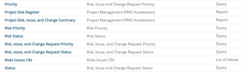

    I'm attaching a response from Anil Katta who answered a similar query which may help get you the reporting information you need.
    Question:
    How do we report out Risk Response Strategies? Are there any out of the box reports (Jaspersoft), ad-hoc means, or portlet views that display the Response Strategies associated with a risk?
    Answer:
    The screenshot shows two Reports and few Queries that are available in Jaspersoft Advanced reporting related to the Risk.
    You may utilise these queries to create new reports per requirements.
    Else you can add the attributes from RISK object to the Data Warehouse and build the Adhoc views based on your requirement.
    Let us know if that helps.
    Thanks, Kyle_R.

    None of those have response strategies. We know how to write those queries. The question to CA is about why create custom objects and tables if those cannot be added to datawarehouse? Those attributes of no use if cannot be reported in supposrted manner. Customers get furious when they hear that an attribute cannot be added to DWH, for whatever reason. Especially when you cannot create a subobject under risk to unnecessarily mimic the same OOTB feature that is locked for configuration. We cannot even hide response strategy subpage!.
