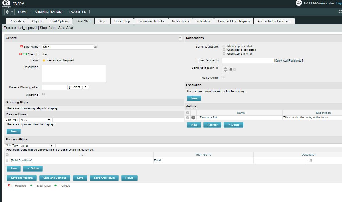

    Yup, I actually just did this a couple weeks ago after realizing this had never happened, can't believe I never noticed. We already had a process convering the idea conversion process so I just added a new step to set this field like below. If you don't already have a process you'd just need to create a new one thats checking for when the idea status is changed to Converted and add this same sort of step.

    Hi L.Elias
    I've set up on the action for "Set Open for Time Entry" however I'm not sure what the "Then Go To" next option should be. Would you be able to clarify what this should look like?
    Many Thanks

    Hello,
    Generally when you set an system action (or other operations) , on a step Action, on the "Then Go To" field , the next sequential step should be referenced in. For example, if post completion of Time Entry step, the process needs to complete, then the field should be set to the step "Finish". If the process still has further actions remaining, then the next logical step should be referenced in this field.
    The "Then Go To" field is used for connecting the next available step, to keep the process workflow propagating.
    Example:
    Hope this helps.
    Regards,
    Samik

    Hi Rich.
    Your Process has to update Open for time entry in the IDEA after Project was getting created. if IDEA open time entry has closed before converting to project, then project open time entry also closed.
    I would recommend you to create a process on project object on create mode and your gel script has to verify, if project has created based on Idea, then process should update the corresponding Idea open for time entry to "No"
    Thanks
    Senthil
