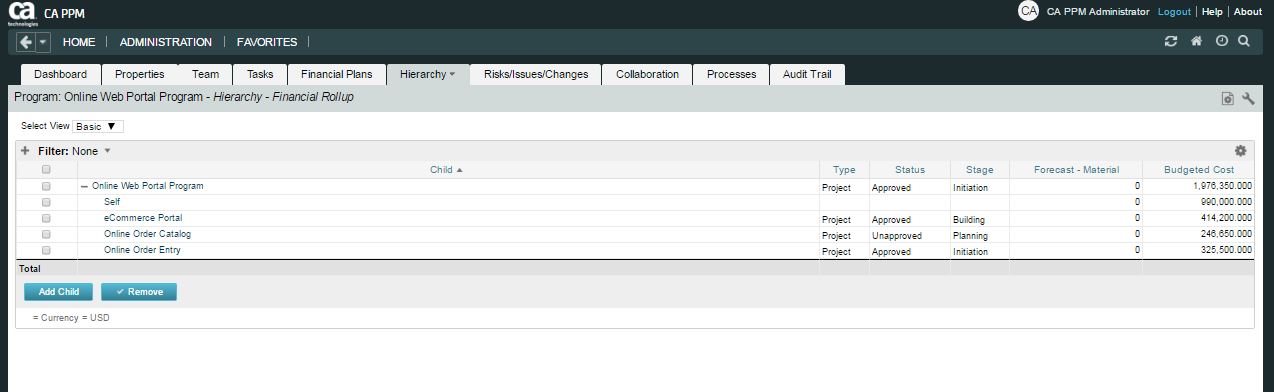

When you are looking for a rolled up budgeted cost (i.e. Parent budgeted cost + Child(s) budgeted cost), you will need to consider all the hierarchy, that is self record for the parent and then individual records for the children, with respect to budgeted cost.
Hence, you will need to consider the inv_flat_hierarchies tables. You will need to reference this table , along with Fin_Financials, twice, once for the parent and once for the child.
Example:
Considering the following program, the parent is having the budget (self) -> 990,000 and the respective children as shown below:
Hence, for the DB we will need to get the above respective calculation for the Self and the child projects. You can refer to the following query, which respectively traverses the tables from parent as well as from child and finally adds the data to give the consolidated budget. You can explore similar options
