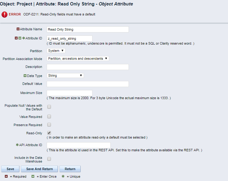

1) CA PPM gives this error when you're trying to create this attribute without a default value

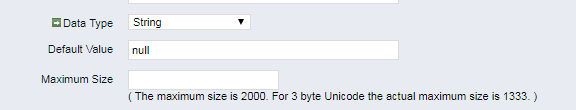

2) The trick is to type "null" (lowercase) as default value, then save

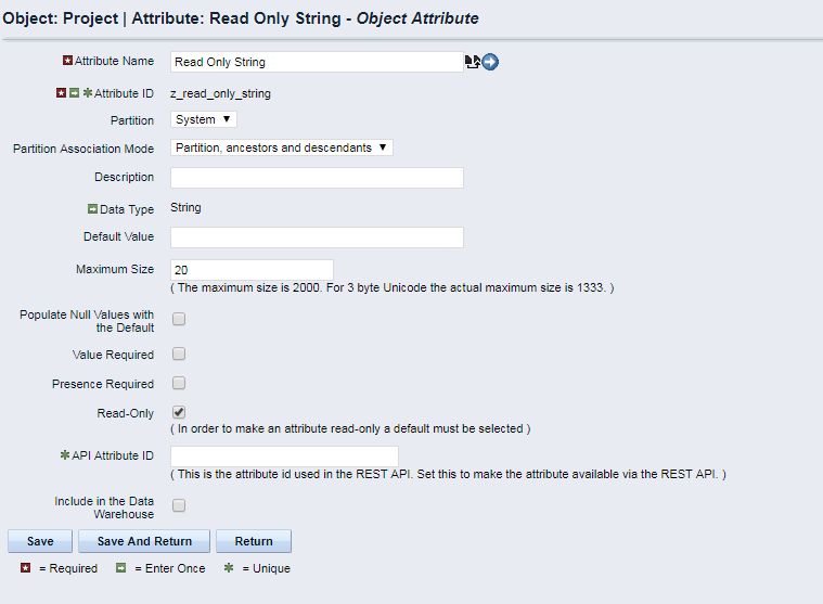

3) CA PPM accepts it, and "null" is not the default value, but it is NULL
