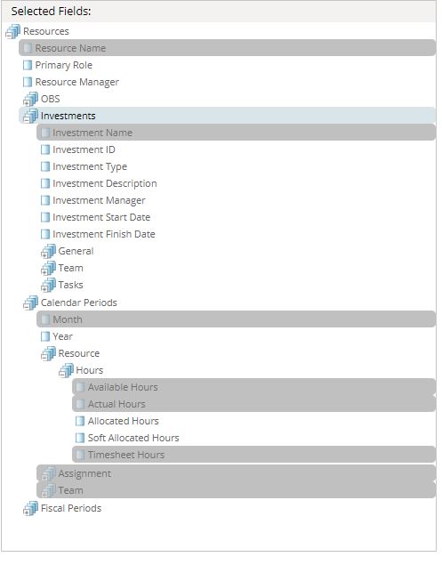

    I am using an #adhoc #jaspersoft ##advancedreporting view for resource actual time.  The fields are below:
    Resources Domain
    Resource Name, Investment Name
    Calendar Periods - Month
       Assignment - Hours - Assignment Actual Hours
    The assignment actual hours are incorrect or not listed for some resources when compared to a portlet and to the OOB "Resource Assignment and Allocations" report.  The only filters I have are for lvl2 OBS and Month.  A snapshot of the fields i am using are below.
    Has anyone experienced a similar issue and been able to correct it?
    Thanks!

    Hi Shubham,
    Thanks for the reply.  I should have clarified, this as after the Load Data Warehouse job has been executed.  I am also looking at resource time from a few months ago, so no additional timesheets are being posted for that month.
