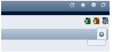

    The Portlet is showing error and when clicked in Options(gear icon) it doesn't show "Configure".

    4. When User went to the portlet page and opened the Bookmark , a Pop-up window opened . User clicked on Restore Defaults and removed few columns from the List Layout and Saved it , but nothing worked.
