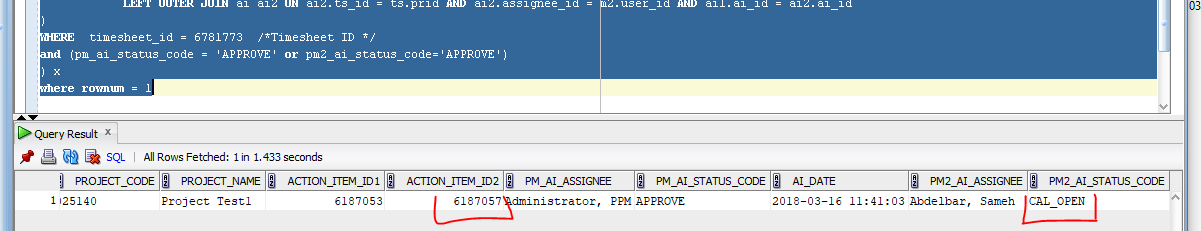

    So, firstly I select Action Item which need to be updated. based on my own query (second AI should be Auto-Approved by that XOG). Note: That first AI which was Approved in GUI before to initiate the "Update AI action" step which we're checking.

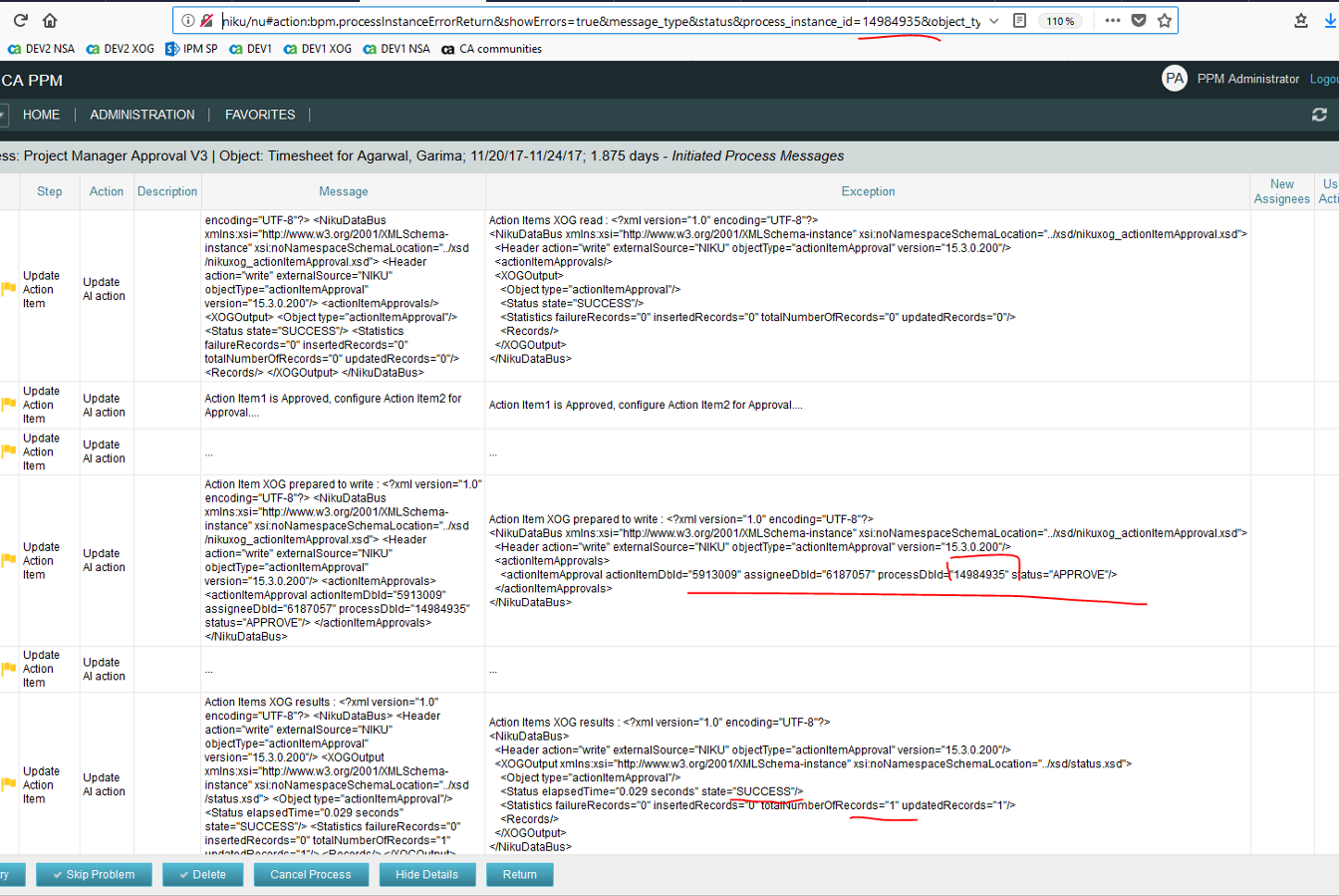

    Then in PM Approval process, custom GEL process step, I build XOG write based on results from query:
    Note: When performed XOG read, I got no results...so that param processDbId, in XOG write I got as process instance ID from DB - hope it's right ID.
    XOG write was successfull (I've tried it also through xog.client Clarity GUI, , it's the same - nothing changed), however Action Item remained opened. Do you know why?
    This AI with ID 6187057 should be Approved after that XOG....

    User who Submitted Timesheet, so in fact initiated that TS Approval process is a common user to whom TS belongs to.
    Action Items are assigned to 6 different users as you can see from last screenshot.
    I'm logged in as admin of course but it shouldn't influence the process XOG, isn't it?
