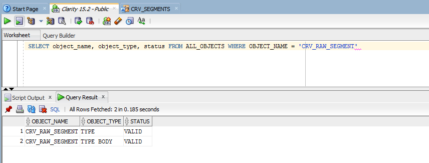

    Can you please check whether CRV_RAW_SEGMENT object type and table type is valid or not?, if the object is not valid then compile the both object.
    which environment are you currently upgrade?, if non production, then you can try to upgrade on force method.
    SELECT * FROM ALL_OBJECTS WHERE OBJECT_NAME = 'CRV_RAW_SEGMENT'

    Posted Aug 15, 2017 02:27 PM
    Hey Senthil,
    Attached are the results I get when I query the ALL_OBJECTS table for CRV_RAW_SEGMENT
    What statement would I need to run to compile the two? This is a non-production environment. The current clarity folder is what was being built as part of the upgrade. Do I rename this to clarity_old? From there, do I re-run the install.sh script with sh ./install.sh or is it a different command?

    You need to compile CRV_RAW_SEGMENT Object Type and ensure the object is valid
    before execute install.sh or install.bat
     Yes. Please Follow the below steps:
    1.  Stop the clarity services, if services already started
    2.  Rename clarity folder to clarity_old
    2. Rename Clarity_prev folder to Clarity.
    3. Start the upgrade activity. (The upgrade will start from clarity 15.1 to clarity 15.2)
    Thanks
    Senthil
