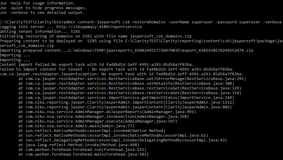

    Thanks a lot for your response!!! Here are the log and the screenshot. As you will see it's the same issue happened before.
    Regards,
    Daniel
    Attachment(s)
    log
    admin.log   6 KB 1 version
  • 9.  RE: Re: Import Jaspersoft csk failed
    Broadcom Employee
    Posted 04-16-2020 04:10 AM
    Hi Daniel
    Thanks for sharing the admin log and the error i see is below and this is very generic error and i would like to have some additional information.
    1. What is your Jaspersoft version and version of Tomcat used.
    2. What is your database? (Oracle/MSSQL)
    3. Can you share your properties.xml and you can mask the IP and password's
    4/15/20, 2:13 PM (admin) Failed to import content for tenant  4/15/20, 2:13 PM (admin) Failed to import content for tenant  com.ca.jasper.restAdapter.JasperException: No export task with id 48f5d450-25e6-402a-a02a-031c6a9eae34. at com.ca.jasper.restAdapter.services.RestServiceBase.setJSErrorMesage(RestServiceBase.java:291) at com.ca.jasper.restAdapter.services.RestServiceBase.setMetaInfo(RestServiceBase.java:308) at com.ca.jasper.restAdapter.services.RestServiceBase.restServiceGet(RestServiceBase.java:329) at com.ca.jasper.restAdapter.services.RestServiceBase.restServiceGet(RestServiceBase.java:318) at com.ca.jasper.restAdapter.services.ImportService.getImportStatus(ImportService.java:249) at com.niku.reporting.jasper.ClarityJasperAdmin.importContent(ClarityJasperAdmin.java:1259) at com.niku.reporting.jasper.ClarityJasperAdmin.jasperContent(ClarityJasperAdmin.java:848) at com.niku.reporting.jasper.importexport.JasperContentCommand.execute(JasperContentCommand.java:191) at com.niku.reporting.jasper.ClarityJasperAdmin.executeCommand(ClarityJasperAdmin.java:3888) at com.niku.nsa.service.AdminManager.invokeAction(AdminManager.java:311) at com.niku.nsa.service.AdminManager.execute(AdminManager.java:207) at com.niku.nsa.service.Admin.main(Admin.java:78) at java.base/jdk.internal.reflect.NativeMethodAccessorImpl.invoke0(Native Method) at java.base/jdk.internal.reflect.NativeMethodAccessorImpl.invoke(NativeMethodAccessorImpl.java:62) at java.base/jdk.internal.reflect.DelegatingMethodAccessorImpl.invoke(DelegatingMethodAccessorImpl.java:43) at java.base/java.lang.reflect.Method.invoke(Method.java:566) at com.werken.forehead.Forehead.run(Forehead.java:551) at com.werken.forehead.Forehead.main(Forehead.java:581)

    root@centos7 ~]# admin content-jaspersoft csk -userName superuser -password superuser
    Content File Name  jaspersoft_csk.zip
    Logging into server ... http://centos7:8080/reportservice
    Getting tenant information... organization_1
    Initiating importing on organization_1 with file name jaspersoft_csk.zip
    Preparing content to be deployed on  organization_1 using file /home/clarity/app/reporting/content/csk/jaspersoft/package/jaspersoft_csk.zip
    Importing prepared content.../tmp/jaasreports_5194228940840389672/export_15473388037653574557.zip
    Importing....
    Importing....
    Content import failed.No export task with id 1f3c4d3f-3188-4230-bdf2-f4203ec2b90c.
    Failed to import content for tenant  : No export task with id 1f3c4d3f-3188-4230-bdf2-f4203ec2b90c.com.niku.nsa.service.ExecutableException: com.ca.jasper.restAdapter.JasperException: No export task with id 1f3c4d3f-3188-4230-bdf2-f4203ec2b90c. at com.niku.reporting.jasper.importexport.JasperContentCommand.execute(JasperContentCommand.java:244) at com.niku.reporting.jasper.ClarityJasperAdmin.executeCommand(ClarityJasperAdmin.java:3888) at com.niku.nsa.service.AdminManager.invokeAction(AdminManager.java:311) at com.niku.nsa.service.AdminManager.execute(AdminManager.java:207) at com.niku.nsa.service.Admin.main(Admin.java:78) at java.base/jdk.internal.reflect.NativeMethodAccessorImpl.invoke0(Native Method) at java.base/jdk.internal.reflect.NativeMethodAccessorImpl.invoke(NativeMethodAccessorImpl.java:62) at java.base/jdk.internal.reflect.DelegatingMethodAccessorImpl.invoke(DelegatingMethodAccessorImpl.java:43) at java.base/java.lang.reflect.Method.invoke(Method.java:566) at com.werken.forehead.Forehead.run(Forehead.java:551) at com.werken.forehead.Forehead.main(Forehead.java:581)
    The Catalina.out log shows:
    2020-05-05 22:47:17,695 ERROR ImportRunnable,pool-14-thread-4:78 [root|superuser] - Import failed:2020-05-05 22:47:17,695 ERROR ImportRunnable,pool-14-thread-4:78 [root|superuser] - Import failed:
    com.jaspersoft.jasperserver.export.service.ImportFailedException: Import failed. Reason: A mapping for class com.jaspersoft.jasperserver.export.modules.repository.beans.ResourceBean already exists at com.jaspersoft.jasperserver.export.service.impl.ImportExportServiceImpl.startImport(ImportExportServiceImpl.java:236) at com.jaspersoft.ji.logging.audit.export.service.AuditCapableImportExportServiceImpl.startImport(AuditCapableImportExportServiceImpl.java:38) at com.jaspersoft.jasperserver.export.service.impl.ImportExportServiceImpl.doImport(ImportExportServiceImpl.java:143) at com.jaspersoft.jasperserver.remote.services.async.ImportRunnable.run(ImportRunnable.java:63) at com.jaspersoft.jasperserver.remote.services.async.ImportExportTask$1.run(ImportExportTask.java:124) at com.jaspersoft.jasperserver.api.logging.util.LoggableExecutorService$1.run(LoggableExecutorService.java:81) at java.util.concurrent.Executors$RunnableAdapter.call(Executors.java:511) at java.util.concurrent.FutureTask.run(FutureTask.java:266) at java.util.concurrent.ThreadPoolExecutor.runWorker(ThreadPoolExecutor.java:1149) at java.util.concurrent.ThreadPoolExecutor$Worker.run(ThreadPoolExecutor.java:624) at java.lang.Thread.run(Thread.java:748)

    Hi Arthur - have you tried applying this solution yet: https://community.broadcom.com/enterprisesoftware/communities/community-home/digestviewer/viewthread?GroupId=1747&MessageKey=b7e14594-8492-4016-a728-4cc472a604b8&CommunityKey=7f0cbca3-5f93-4d44-a369-1a8ce98f5578&tab=digestviewer&ReturnUrl=%2fenterprisesoftware%2fcommunities%2fcommunity-home%2fdigestviewer%3fcommunitykey%3d7f0cbca3-5f93-4d44-a369-1a8ce98f5578%26tab%3ddigestviewer
    Let me know if this works for you. Thank you -Nika

  • 26.  RE: Re: Import Jaspersoft csk failed
    Posted 05-07-2020 08:08 AM
    Hi Nika,
    I reinstalled Jaspersoft and it worked!
    I guess I was using a wrong version of Tomcat.
    Thanks for your help!
    Arthur

  • 28.  RE: Re: Import Jaspersoft csk failed
    Posted 05-07-2020 06:36 PM
    Hi Nika, Arthur and Suman,
    I also resolved the issue. Thanks to Arthur he gave me the "clue..." I used the same version from tomcat 8.5.49 from PPM server to the Jasper server and this is the issue. The installation from Jasper must use the version 8.5.30 when I change this version it works. The import works!
    Thank you very much Nika and Suman for your help and also Arthur for the feedback around the version.
    Kind regards,
    Daniel
