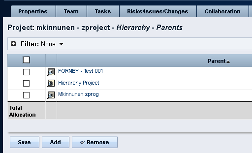

  • 4.  Re: Which all way we can connect a child project to parent project and master project
    Posted Oct 12, 2017 03:24 PM
    The Masterproject - Subproject functionality works so that  you add subprojects to a masterproject
    On the hierarchy tab there is a Parents subpage where you can add parents ie masterprojects in this case.
    Child projects can be added on either Rollup subpage of the Hierarchy tab.
     The subprojects and childprojects create the same database entries.

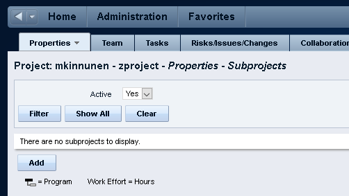

  • 5.  Re: Which all way we can connect a child project to parent project and master project
    Posted Oct 12, 2017 04:37 PM
    In OWB it is the same thing you ad subprojects by clicking the Subprojects icon on the Project tab and then insert to select existing projects.
    The option is to open the task submenu with right click and select Insert Subproject...
    OWB did not seem to allow create Subprojects by inserting/adding tasks and selecting the type as Project.
