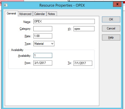

    If you look at the properties of the material resource
    The first thing that strikes me is that there is no availability. Secondly the availability dates are blank.
    Doesn't that mean that the resource is not allocated to the project?
    Setting values for those
    Does not make a difference and the value in Availability (1) does not stick.

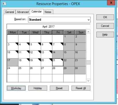

    The next thing is to look at the calendar.
    Can't really say how the working days in the resource calendar are because of the Windows 10 theme.
    However selecting a date and clicking Workday marks the right top corner with black to indicate override.
    When I Autoschedule after that
    No problem at all.

    I did some testing, and your are right, it is because of the availability. I have been even able to reproduce the issue with a file created in OWB (no CA PPM) by removing the availability. After marking in OWB one random day (like 1.1.1901) as working day for the material resource solves the issue.
    I have also set explicitly one day as working day in the CA PPM material resource calendar.
    After this, I'm not able to reproduce the issue anymore.
    It did not matter which day, marking a working day as working day is enough.
    We will do some more tests, but this looks like a possible workaround for the issue.
