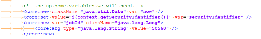

    So I was able to fire a scheduled job via a process.  In my test case, I define a process that fires a ExecuteProcessJob for another process.
    You need a couple to things to configure the gel action script.
    You need the id for the via the address – in my test I am using com.niku.bpm.jobs.ExecuteProcessJob.
    You will also need the securityIdentifier that the process is running under along with the current date to schedule the execution.
    So my process which I fire is called Debug Schedule that I fire via the Organizer.
    I see that my process runs and we also see the SystemConfigurationFiles process is run via the scheduler
    So here is the gel action script.

              <!-- setup some variables we will need -->
              <core:new className="java.util.Date" var="now" />
              <core:set value="${context.getSecurityIdentifier()}" var="securityIdentifier" />
              <core:new var="jobId" className="java.lang.Long">
                   <core:arg type="java.lang.String" value="50560" />
              </core:new>

    you should be using the Job ID from the Scheduled Jobs view but not the Job Definition ID as shown in the example script. Also, I had to enclose the parameter values with ${} as above changing from
     <core:arg value="param2"/>
    to
     <core:arg value="${param2}"/>
    The problem that I am facing is that context.getSecurityIdentifier() returns -1. What is the PPM version you are using?

    Execute the process from the GUI as you would like it to run automatically. Then check the Job logs for the last execution and fetch the job id from there. Use that id in your script and it should work fine. Also, remember to check bg-ca.log it usually provides some useful information.
    Here is my working example for invoking "Update Actuals from Estimates" job using gel action
    <gel:script xmlns:core="jelly:core" xmlns:gel="jelly:com.niku.union.gel.GELTagLibrary" xmlns:util="jelly:util" xmlns:soap="jelly:com.niku.union.gel.SOAPTagLibrary"
    xmlns:soap-env="http://schemas.xmlsoap.org/soap/envelope/" xmlns:sql="jelly:sql" xmlns:xog="http://www.niku.com/xog" xmlns:xsi="http://www.w3.org/2001/XMLSchema-instance">
    <gel:log>version 1.0 </gel:log>
    <core:catch var="v_exception">
    <core:arg type="java.lang.String" value="5062148" />
    </core:new>
    <!-- get security ID -->
    <core:invokeStatic className="com.niku.union.utility.UtilityThreadLocal" method="getSecurityIdentifier" var="utlSecID" />
    <gel:log>utl user id: ${utlSecID.getUserId()}</gel:log>
    <gel:log>utlSecID: ${utlSecID.toString()}</gel:log>
    <!-- get the scheduler -->
    <core:invokeStatic className="com.niku.union.njs.SchedulerFactory" method="getInstance" var="scheduler" />
    <gel:log>invokeStatic scheduler: ${scheduler.toString()}</gel:log>
    <!-- need a job to submit to the scheduler base on existing job id-->
    <core:invokeStatic className="com.niku.njs.JobImpl" method="retrieveJob" var="jobImpl">
    <core:arg type="long" value="${jobId}"/>
    <core:arg type="com.niku.union.security.SecurityIdentifier" value="${utlSecID}"/>
    </core:invokeStatic>
    <gel:log>new jobImpl: ${jobImpl.getParamsAsString()}</gel:log>
    <!-- define our parameters we need for this job and add them to the job -->
    <core:new className="java.util.ArrayList" var="jobParameters" />
    <core:new className="com.niku.njs.JobParameter" var="param1">
    <core:arg type="java.lang.String" value="project_name"/>
    <core:arg type="java.lang.String" value="Test"/>
    <core:arg type="java.lang.String" value="java.lang.String"/>
    </core:new>
    <core:invoke method="add" on="${jobParameters}" var="dummy">
    <core:arg value="${param1}"/>
    </core:invoke>
    <core:set value='${jobImpl.setParams(jobParameters)}' var='dummy' />
    <gel:log>add jobParameters: ${jobParameters.toString()}</gel:log>
    <!-- Set some job properties mostly run now -->
    <core:set value='${jobImpl.setScheduleDate(now)}' var='dummy' />
    <core:set value='${jobImpl.setStartDate(now)}' var='dummy' />
    <core:set value='${jobImpl.setEndDate(now)}' var='dummy' />
    <core:set value='${jobImpl.setRecurNow(true)}' var='dummy' />
    <core:set value='${jobImpl.setStatus("NOT_SCHEDULED")}' var='dummy' />
    <core:set value='${jobImpl.setSchedulerListener("JAVA", "com.niku.projmgr.jobs.UpdateTeamAllocationData")}' var='dummy' />
    <gel:log>run jobImpl: ${jobImpl.toString()}</gel:log>
    <!-- schedule the job with the scheduler -->
    <core:invoke method="schedule" on="${scheduler}" var="dummy">
    <core:arg type="com.niku.njs.JobImpl" value="${jobImpl}"/>
    </core:invoke>
    <gel:log>invoke schedule: ${scheduler.toString()}</gel:log>
    <gel:log>Status: ${jobImpl.getStatus()}</gel:log>
    </core:catch>
    <core:choose>
    <!-- Check for errors -->
    <core:when test="${v_exception != null}">
    <gel:log>Error: ${v_exception}</gel:log>
    </core:when>
    <core:otherwise/>
    </core:choose>
    </gel:script>
