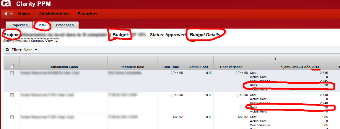

    Hi,
      I'm using Clarity R14.2, and I would like to know or understand witch Slice requests to use for extracting by Year (or month,or wathever) the Budget Plan in order to make a NSQL portlet query.
    Below a sample of a Budget plan associated with a project :
      I've try to look into the configuration (Administration > Data Administration > Time Slices), but I'vent find any request to respond to my need. bellow there are the tests done:

    Please not that I want to retreive the Unit amount not a cost.

  • 2.  Re: Whitch slice request to use for getting the Unit value from Project BUDGET plan
    Posted Nov 05, 2015 11:06 AM
    If you are looking at the planned data on the budget, you should look at -
    odf_ssl_cst_dtl_cost cst
    fin_cost_plan_details dtl
    fin_plans fin
    Join conditions
    cst.prj_object_id = dtl.id and
    dtl.plan_id = fin.id and
    fin.is_plan_of_record = 1 and
    fin.object_id = <project_id> and
    fin.plan_type_code = 'BUDGET

    Hi navzjoshi00,
      You have point me in right direction.
      To adjust the answer, As I'm looking for unit of the budget plan, the table have a different name : odf_ssl_cst_dtl_units
      I've tested with the following query :
    SELECT
      I.ID,
      I.CODE,
      FP.NAME,
      FP.ID FP_ID,
      FPD.ID FPD_ID,
      FPD.TOTAL_UNITS,
      R.UNIQUE_NAME,
      SL.START_DATE,
      SL.SLICE *365
    FROM
      INV_INVESTMENTS I
        INNER JOIN FIN_PLANS FP ON (FP.OBJECT_ID = I.ID AND FP.OBJECT_CODE =  I.ODF_OBJECT_CODE AND FP.IS_PLAN_OF_RECORD = 1 AND PLAN_TYPE_CODE = 'BUDGET')
          INNER JOIN FIN_COST_PLAN_DETAILS FPD on (FPD.PLAN_ID = FP.ID)
            INNER JOIN SRM_RESOURCES R ON (R.ID = FPD.ROLE_ID)
                INNER JOIN odf_ssl_cst_dtl_units SL ON (SL.PRJ_OBJECT_ID = FPD.ID)
    WHERE
      (1=1)
    AND I.CODE = '<Project Code>'
    Please note the "time 365" after SL.SLICE. This is due du the fact that we got Yearly Fiscal period, and the odf_ssl_cst_dtl_units.SLICE correspond to the number of unit dived by the number of day in the fiscal period.
    Problem solved !
    Thanks for the hint !
