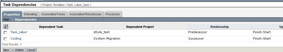

    Just created these
    and have no problem seeing this

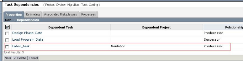

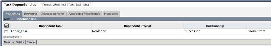

    while in the other project looks like this
    Is that statement restricting you from doing what you want to do?
