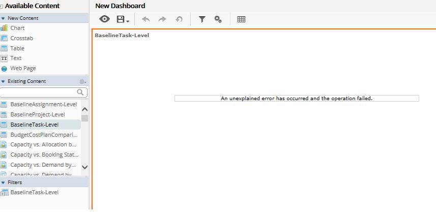

    We are unable to create dashboards on advanced reporting from an adhoc view that created from a topic.
    it is showing "an unexpected error has occured"
    there is no errors on jasper logs
    and the same view is running successfully when selecting it individually.
    Note:- it is possible if you are creating the view directly from domain.but as a topic it is not working

    1.created adhoc report using home--> create adhoc view
    2.selected the in build FInancial Management domain and chose the required fields.
    3.Navigate to Save as topic
    4.Saved the topic under "MyOrganization"-->"My OrganizationViews"-->"Financial Management"-->"Topic"-->TestTopic
    5.Created the view according to this topic--->TestView
    6.Topic Saved.
    7.Navigate to HOME-->Create Dashboards-->Drag "Test view" to it ..
    Getting the below error :-
    couldn't find any logs for this error in the back end

    Thanks for the step and I could reproduce it and I got the below error

    Agreed it looks buggy, if you create a view from Topic and use in dashboard it breaks. Stay tuned I will work with Jaspersoft and come back to you.

    I created a bug  CLRT-81070  Dashboard cannot be created from adhoc views created from Topic and once I find the fix will update you.
    The cause behind the same is we are hiding the default topic folder from the organization created, so we need to re evaluate.
