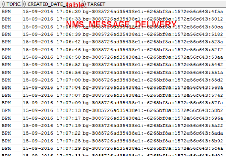

2nd real example, an update event and from NMS_MESSAGES table, fields SEND_DATE and EXPIRATION_DATE have 2 hours of difference. is this the timeout #1? will it be re-processed after this expiration time?
#1 in logs the last message is from 20:24:33, what is later than the expected expiration date.
WARN 2016-09-15 20:24:33,426 [Event Handler pool-3-thread-2] bpm.eventmgr (clarity:user4:000000:none) User that created event does not have the right to start process. processID: 5001000 userId: 5000112
On the other hand in previous screenshot there are two update entries, but i cannot confirm if the user generated two events in this short interval of time or if both entries were generated by the same event (a duplicate)?
Anyway, for an single event i can in NMS_MESSAGE_DELIVERY more than 900 entries in an hour
