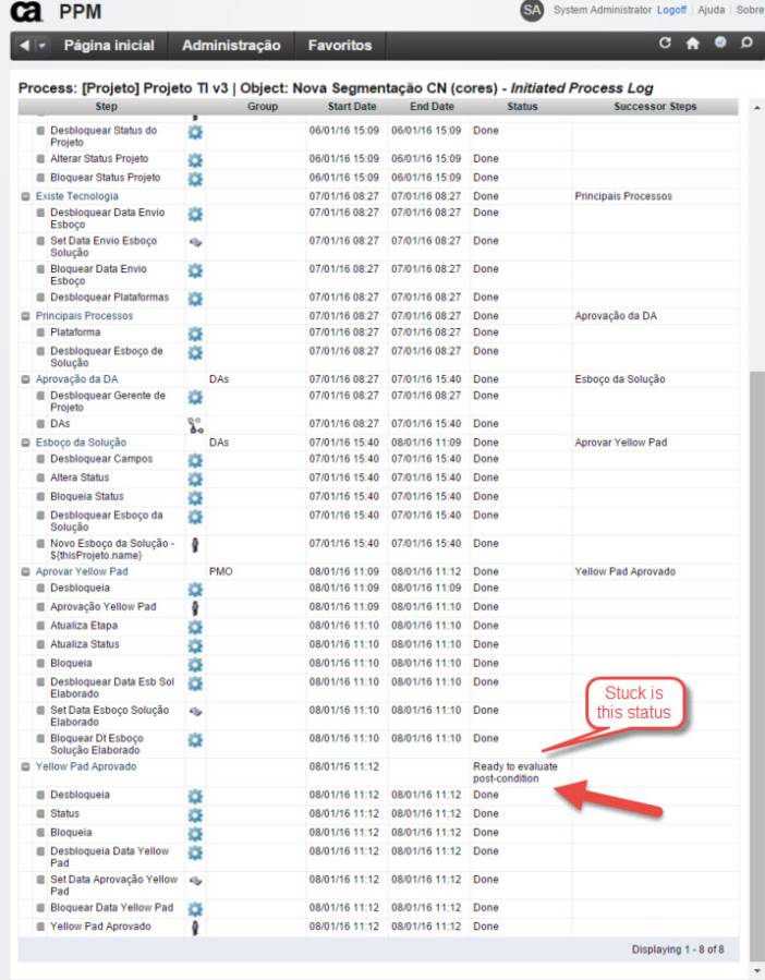

    We have a process that is "stuck" in a manual action step.
    The status is "Ready to evaluate post-condition", but the approver who received the action item had already approved.

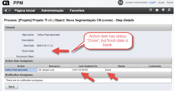

    On the process step details page, we can see that the action item has status "Done", but in the General tab the attribute "Finish Date" is blank.
    It seems that this process is "stuck".
    I have checked the post condition step in the process definition, and if just one approver approves, the post-condition should had been attended.
    This problem does not occur in other processes.
    What can I do is this situation?

    1. Anything odd in the bg-ca logs?
    2. Is this the only process instance that is stuck? Or are there other instances. If there are others, you may want to check the post condition pipeline.
    3 In general, is the process engine loaded with many errored and aborted processes? See the link below to for best practices for process engine cleanup CA Clarity Tuesday Tips - Process Maintenance

    Thank you Ruchika.
    You were right about post condition pipeline. After all, we had to increase the pipeline threads.
    But first, we had to open a support ticket requesting restart de BG Service. After BG restart, all process began to work again.
