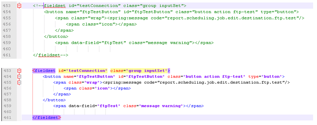

    You may also uncomment the testConnection button for the ftp, which comes just after the ftpServerOutput section in the file.  These are including the comment in the tag itself, see below how to uncomment it:
    <!--fieldset id="testConnection" class="group inputSet">
      </fieldset-->
    has to become:
    <fieldset id="testConnection" class="group inputSet">
      </fieldset>
    For more information on how exactly to do it, please refer to the attached file.

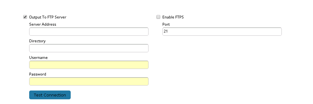

    Once you have enabled the Output to FTP with the steps above,to schedule the report, please do the following:
    1. Connect to PPM - go to Advanced Reporting
    2. Select a report, right-click to Schedule
    3. Click Create Schedule
    4. Go to Output Options
    You will now have the following option to fill in and use (and you also have a Test Connection button to ensure it will work):
    You may schedule your reports and find the output in the FTP directory of your choice.
