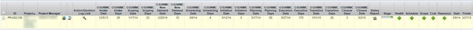

    By capturing this all as hard data on the object - anyone can use if for whatever they need. Below, I've merely added the columns to the project list to demonstrate.

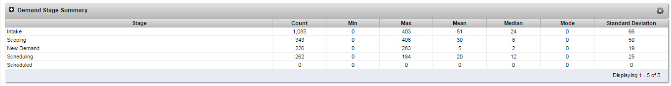

    It's real easy to aggregate:

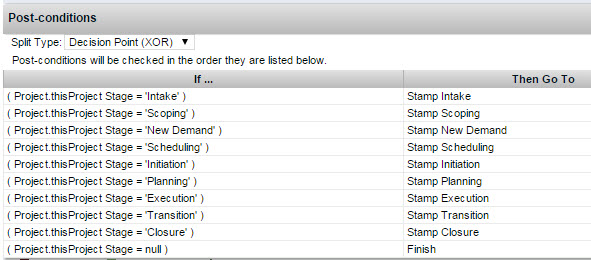

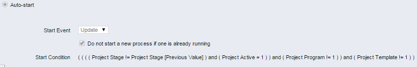

    For lifecycle 'stamping' I have an auto-start update process that looks for the stage change event:
    ...then stamp the appropriate Stage date and, if the days in stage is Null, writes a zero.
    Each morning a job runs, evaluates if yesterday was a business day, looks at the stage then adds one to the appropriate days in stage. This gives us true 'business days in stage'.
