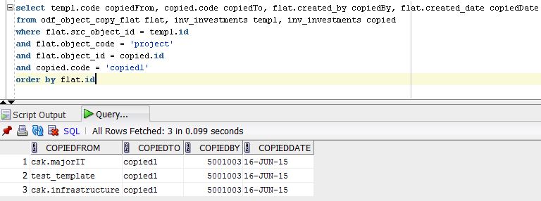

    The table ODF_OBJECT_COPY_FLAT stores the source and destination project's internal IDs and keep a history of each unique combination of the source and destination projects.
    Here is a query to identify the internal ID of a template from which a project has been created or copied from. This does not include task copy.
    select templ.code copiedFrom, copied.code copiedTo, flat.created_by copiedBy, flat.created_date copiedDate
    from odf_object_copy_flat flat, inv_investments templ, inv_investments copied
    where flat.src_object_id = templ.id
    and flat.object_code = 'project'
    and flat.object_id = copied.id
    Example result from a project 'copied1' created from a template 'csk.majorIT', followed by a copy project done from template 'test_template', again from template 'csk.infrastructure', and again from template 'test_template':

    "followed by a copy project done from template 'test_template'"
    Suppose you create a project A using template T1
    When you run the query, the result will be -
    COPIEDFROM    COPIEDTO    COPIEDBY    COPIEDDATE
    T1                             A                XXXX            XX-XX-XXXX
    On the edit page of the project, you again use the copy from template feature (for the second time) and do the copy from template T2
    T2                             A                XXXX            XX-XX-XXXX
    On the edit page of the project, you again use the copy from template feature (for the third time) and do the copy from template T3
    T3                             A                XXXX            XX-XX-XXXX
