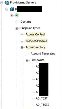

In Connector Xpress, when endpoint is registered under Provisioning Servers - Endpoint types - Endpoints, it is also displayed in Connector Server - Endpoint Types - Endpoint node. Recently, the Endpoints under Connector Server node have disapeared and every action - lookup, search.... on endpoint in Provisioning Manager is resulting in: javax.naming.NamingException: OID for name 'eTADSDirectoryName' was not found within the OID registry
After I discovered this, I have to manually Set managing CS in Connector Xpress, but this did not solve the problem.
Is there any way, to reconnect endpoints on Provisioning server with JCS again? Any help would be appreciated!
Thank you!
Full stack trace down below. I am also attaching Connector Xpress screenshots, to clear the situation.
