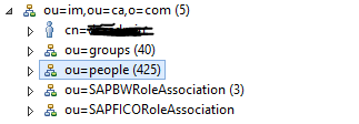

    I have the below LDAP structure setup currently
    When I define a CA Identity Manager connector in governance universe, I want the connector import scope to be limited inside ou=people only. By default it queries from top DSA and imports all users from all ou.

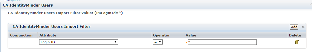

    The filter criteria happens to work for defined attributes, but do not see any option to limit on ou scope.

    This might be possible to specify with regular expression using import filter on the screenshot here. You will need to use Regx to specify with ou=people.
