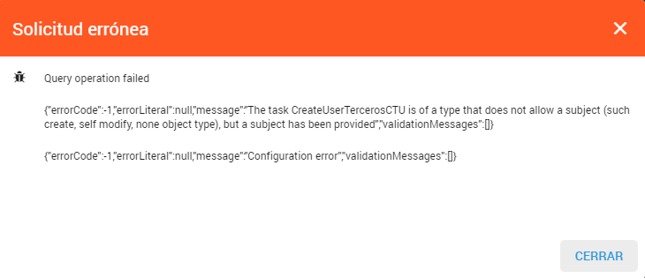

    I have the following error when I try to assign a custom task to a form, then to a module. The error occurs when I try to access the form from the portal as a standard user. The error is presented if the action of the task is to create, it works for modification if the action is to self-modify
    The error is as follows:
    This is a view o tail_ip_log
    ERROR [com.idmlogic.sigma.workers.utils.ExceptionsHelper] (default task-32): ErrorCode: 0, ErrorFamily: GENERAL, Message: com.idmlogic.sigma.backend.exceptions.BackendException: Query operation failed
    BackendMessages:
    Error: Message: Configuration error,
    Error: Message: The task GeneracionTerceroTigoUne is of a type that does not allow a subject (such create, self modify, none object type), but a subject has been provided,
            at com.idmlogic.sigma.connector.ca.v2.connectors.CaimFormServicesConnecetor.getFormData (CaimFormServicesConnecetor.java:59) [sigma.connector.ca.imV2-0.0.2-SNAPSHOT.jar:]
    Any idea of how I can solve it?

    Sorry but the message means exactly the reverse.
    "Error: Message: The task GeneracionTerceroTigoUne is of a type that does not allow a subject (such create, self modify, none object type), but a subject has been provided,"
    This means the task is not expecting a subject (cause of its action or primary object type) but one has been provided.
    This is also confirmed by the description of the error occurrences :
    "The error is presented if the action of the task is to create" => because of the "create" action type.
