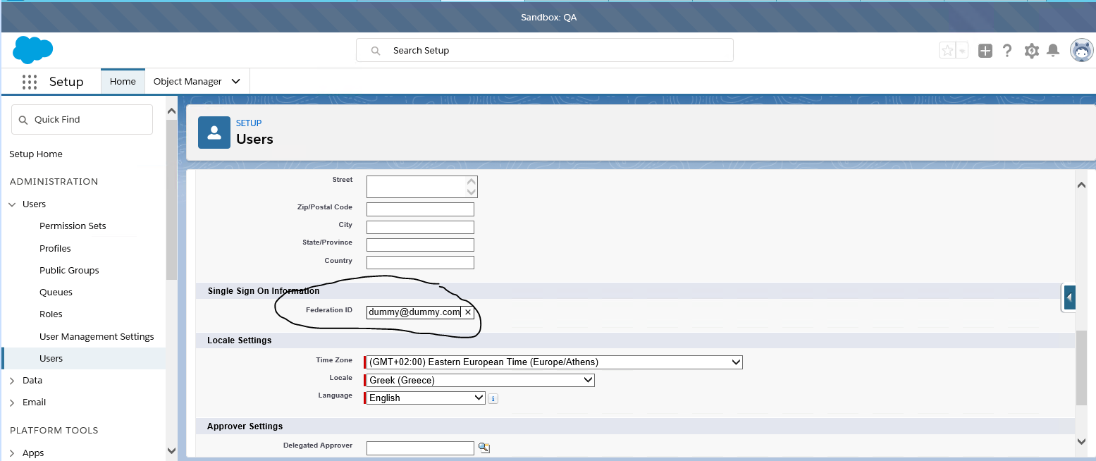

    Hello!
    When creating a user at Salesforrce through IDM, or when modifing the user we need to create/modify the attibute at Salesforce "Federation ID" ?
    Checking the attributes at the endpoint there is no Federation ID, also at the Attribute Mapping there is no option for the Federation ID.
    Federation ID - Salesforce
    Thank you in regards!
