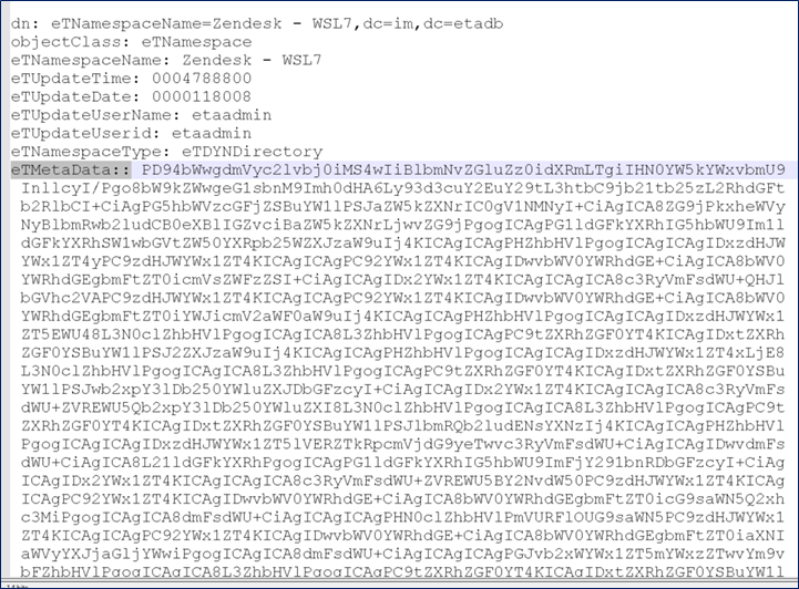

Background: When CX UI is used to push/store its configuration to the IM Provisioning Server, this XML information is stored on the Endpoint Type for this connector as an ldap attribute labeled eTMetaData. Due to the size and UTF-8 characters, this data when exported, is shown as base64 encoded, e.g. double colon (after the ldap attribute).
To view this data, we can use the Linux/Unix command line tool of base64 with the -d switch to decode.
Example below for namespace "Zendesk". See the base64 data in eTMetaData.

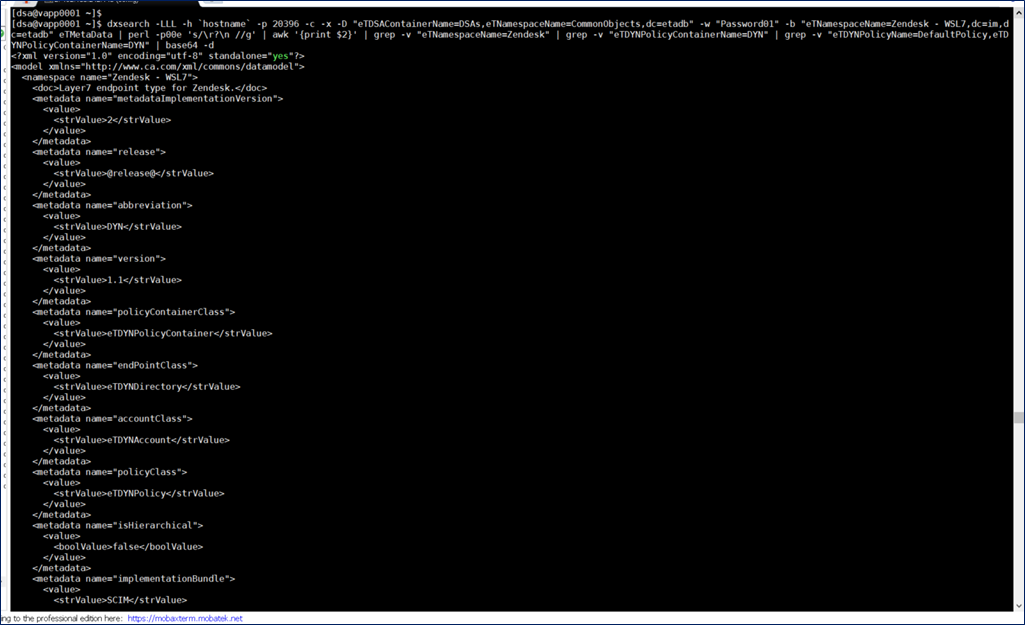

Example:
dxsearch -LLL -h `hostname` -p 20396 -c -x -D "eTDSAContainerName=DSAs,eTNamespaceName=CommonObjects,dc=etadb" -w "Password01" -b "eTNamespaceName=Zendesk - WSL7,dc=im,dc=etadb" eTMetaData | perl -p00e 's/\r?\n //g' | awk '{print $2}' | grep -v "eTNamespaceName=Zendesk" | grep -v "eTDYNPolicyContainerName=DYN" | grep -v "eTDYNPolicyName=DefaultPolicy,eTDYNPolicyContainerName=DYN" | base64 -d
Output:
The above file may be re-directed to a new output file with a time-date-stamp.
