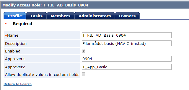

    For our client we have implemented Access roles with custom field containing the approvers. Please find screenshot below for same :-
    Access role description
    Approver 1 here contains the value which corresponds to the location attribute of the approver.
    Approver 2 here contains value of Access Role.
    It is to be noted that Value in these two above mentioned attributes are different for different roles.
    Client wants us to implement workflow approval on "AssignAccessRoleEvent" in a way that approvers are resolve based on the entries in the above mentioned field for the role requested in task. That is suppose a user requests role "T_FIL_AD_Basis_0904" then approvers should be resolved as the users which have location attribute as 0904 and are members of access role T_App_Basic.
