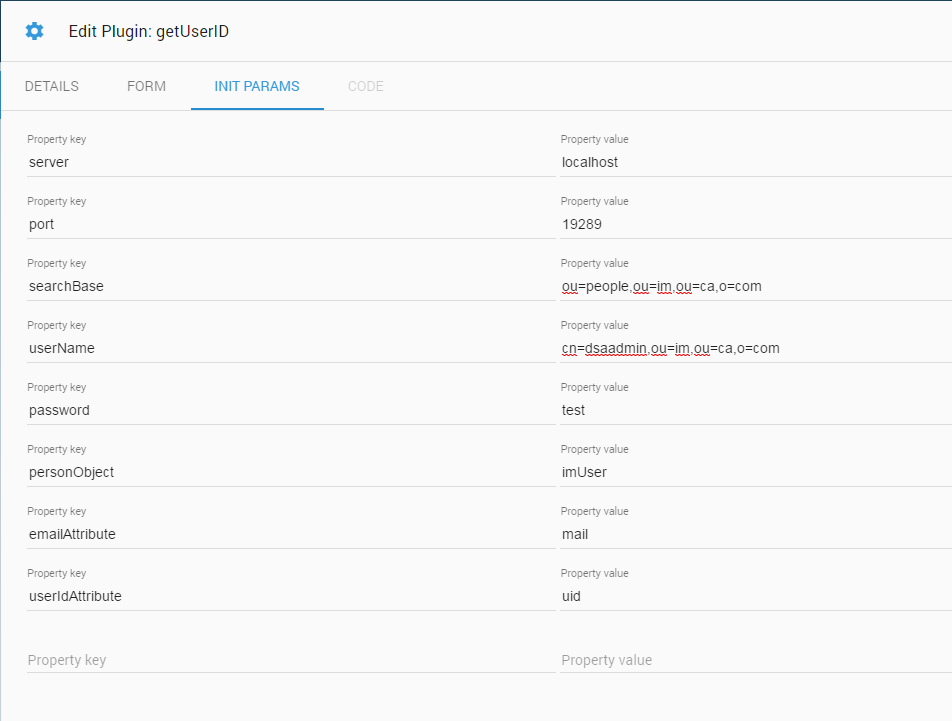

    Moreover, if you have static values you wish to pass to the plugin's function, e.g. the connection details for you LDAP, you can add them to the INIT PARAMS tab of the plugin configuration. For example:
    In you plugin Java code, you can get these parameters by overriding the function "public void initPlugin()" (see example attached).
    The @ExportedServerFunction function is also responsible for the response returned from the plugin. If you wish the plugin to return a set of arguments, simply write the function such that it returns a map (e.g. "Map<String, String>") of the values and their names. In your case it will probably be a mapping between the LDAP attributes and their values. Then, in the form handler code you will receive this map in the the property "returnValue" of the response. For example, if the plugin function returns the map {"userid": "id-test", "email": "email-test"} then you can get the value of email in the following manner: response.returnValue.email;
    Attached is an example for a Java code plugin that connects to LDAP using the init params from the image above. A javascript sample that execute if from within a form handler is:
