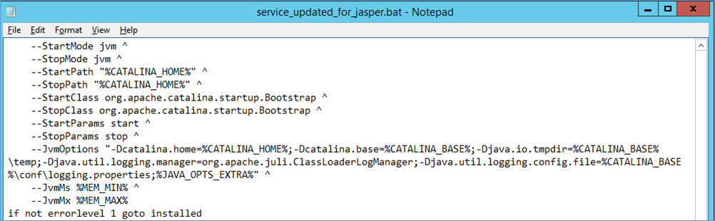

    Resolution:   Create a copy of service.bat and update.
    Step 1:   Declare variables to be used at top of the file.
      Note that the JASPER License was called out with the full path.
      The extra Java options were collected together to allow a single update.
      To manage the max/min memory, and to change it at will, these flags were called out.
    Step 2:  Update the service name to match a useful name for JasperSoft
    I selected CA_Jasper to allow the NT services to align with the other CA services for IMAG
    Step 3:  Update the Java Options with the new variable of JAVA_OPT_EXTRA   and update the minimal (initial) and maximum memory hard-coded values to use the variables.

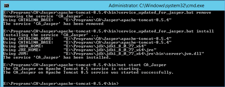

    Step 4:   Save this file, then execute with    service_updated_for_jasper.bat  install
    If you previously installed it, you can remove it via:   service_updated_for_jasper.bat  remove
    Start up the NT service:   net start CA_Jasper

    Enclosing an example of the service_updated_for_jasper.bat file.
