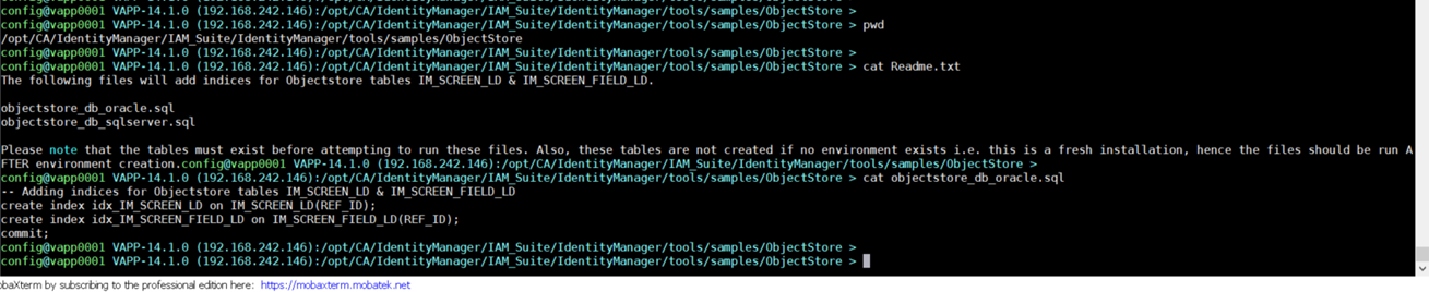

Just a reminder; even on the vApp or standalone deployments; do not forget to add indexes to the IM Screens Tables.
See the readme under the CA Identity Suite samples / tool kit / examples.
NOTE: These IM Screen Tables are built ONLY after an IME is created. If you delete an IME, you will need to re-add these indexes upon creating the new IME.
<Paste in this section to allow easier search ability:>
config@vapp0001 VAPP-14.1.0 (192.168.242.146):/opt/CA/IdentityManager/IAM_Suite/IdentityManager/tools/samples/ObjectStore >
config@vapp0001 VAPP-14.1.0 (192.168.242.146):/opt/CA/IdentityManager/IAM_Suite/IdentityManager/tools/samples/ObjectStore > cat Readme.txt
The following files will add indices for Objectstore tables IM_SCREEN_LD & IM_SCREEN_FIELD_LD.
objectstore_db_oracle.sql
objectstore_db_sqlserver.sql
Please note that the tables must exist before attempting to run these files. Also, these tables are not created if no environment exists i.e. this is a fresh installation, hence the files should be run AFTER environment creation.config@vapp0001 VAPP-14.1.0 (192.168.242.146):/opt/CA/IdentityManager/IAM_Suite/IdentityManager/tools/samples/ObjectStore >
config@vapp0001 VAPP-14.1.0 (192.168.242.146):/opt/CA/IdentityManager/IAM_Suite/IdentityManager/tools/samples/ObjectStore > cat objectstore_db_oracle.sql
-- Adding indices for Objectstore tables IM_SCREEN_LD & IM_SCREEN_FIELD_LD
create index idx_IM_SCREEN_LD on IM_SCREEN_LD(REF_ID);
create index idx_IM_SCREEN_FIELD_LD on IM_SCREEN_FIELD_LD(REF_ID);
commit;

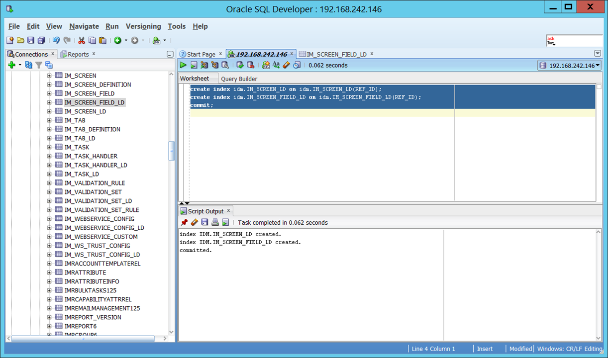

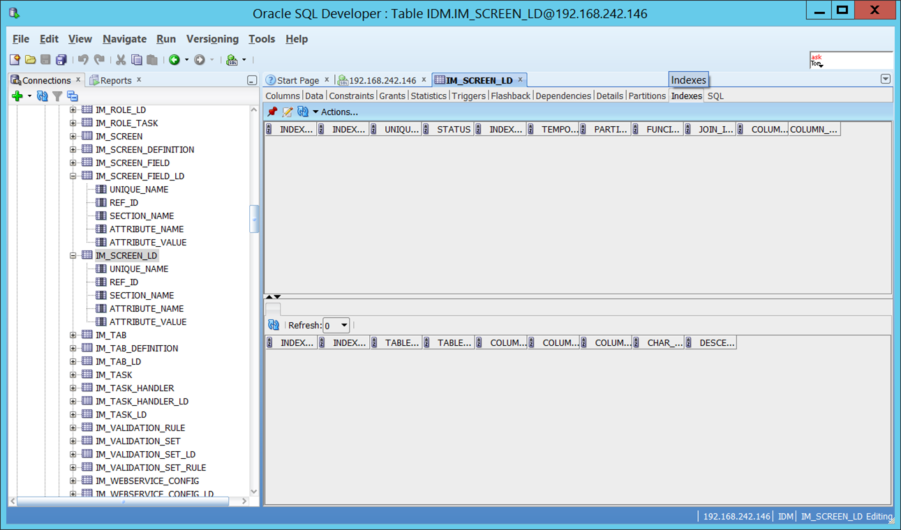

EXAMPLE BEFORE: (no indexes on the two IM Screen Tables)
CREATING INDEXES:
- Copy/Paste example from CA Identity Suite samples; update for your correct naming convention for these two (2) tables, e.g. service_id.IM_SCREEN_LD & service_id.IM_SCREEN_FIELD_LD
AFTER EXAMPLE: Indexes added
Test your startup & Run-n-Operate metrics before and after.
