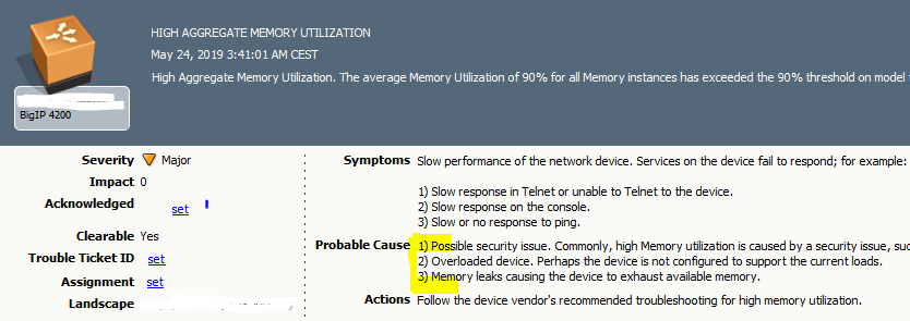

    I would like to use a variable as part of the "Probable causes" alarm description, but I can't find what is the attribute for it.
    My plan is to use Event Procedure to append that, but this key information is missing.

    Hi Joe,
    Not exactly, I don't want to change the Alarm Title in any way, but the information that appears in the "Probable Cause" field, for example:
    I cannot simply edit the event directly because I don't want it to be static. I want to add one Event variable to the text, to make it look like this (e.g.):
    1) Possible security issue on {S 2}. Commonly, high Memory utilization is caused by a security issue, such as a worm or virus operating in your network. This is especially likely to be the cause if no recent changes have been made to the network.
    Is it somehow achievable?

    Posted May 24, 2019 08:56 AM
    To my knowledge there is no way to modify the Probable Cause information. The only thing I can think of is to generate specific events based on the value of the Event Variable(s) to generate an alarm using a specific Probable Cause file.
    Joe
