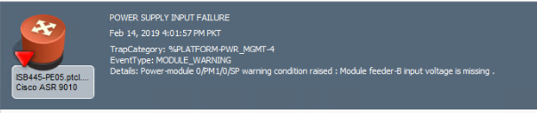

    i am using spectrum 10.2.1 and the issue i am facing is that whenever a Input power supply feeder A or Feeder B is off on my cisco ASR routers the event visible on spectrum through trap is this:
    its never represents any FRU name detail and also not about which feeder input has gone. I need your help is it possible that if there is OID exists for description or any attribute for description in Spectrum we add to this trap definition.

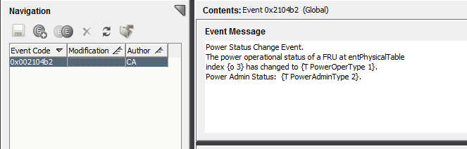

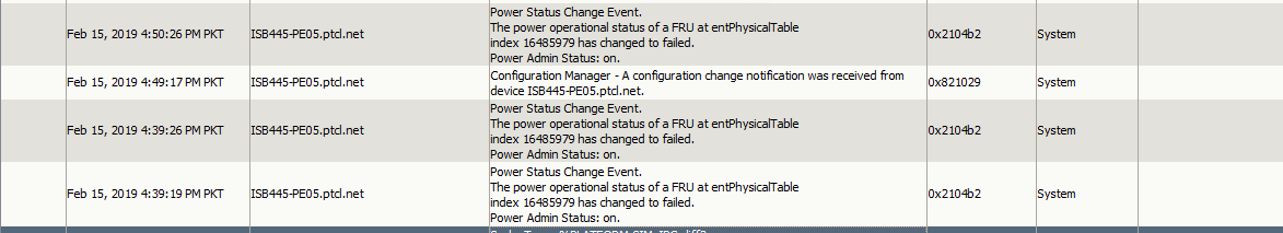

    I think i added images on question its not visible due to some issues. The event generated is:
    0x2104b2.
    kindly guide me what details are required from my side.
    Router is CISCO ASR 9010.
    Here is the syslog event generated for that router but due to performance issue  with SS we disable the Syslog to be forwarded to Spectrum.

    Here is the OID and Trap in which i want to add but don't know in spectrum how the variables/MIB variables are catered. help me to add the variable in trap.
    EntPhysicalName needed.

    Posted Feb 22, 2019 02:56 AM
    IS there need to add index num after the entphysicalname to fetch the name or it will fetch automatically don't know its work or not please check
