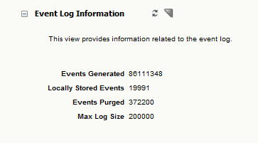

    I'm afraid the action only half worked for max_event_records
    It seems to set the value of Max Log Size to the new value but it doesn't appear to apply it. I did this on one of our landscapes, changing from the default 20,000 to 200,000. I then shutdown the ArchMgr and if you look at the screenshot you see Max Log Size is set to 200,000 yet the Localy Stored Events never went above 20,000.
    Maybe I missed a step ... for info I ran the action against the VNM model.
    Are you able to test and verify?
    Regards, John

    John,
    I ran a quick test. After changing the value of the max_event_records parameter in the .vnmrc file and running the update command on the VNM model, the value of Mas Log Size is changing BUT the underlying code is not changing until a restart of the SpectroSERVER.
    Joe

    Hi Joe
    That's exactly the same as I saw. I guess it's a bug as there is no point at the moment in running the action ...
    Can you flag it and see can you get it fixed?
