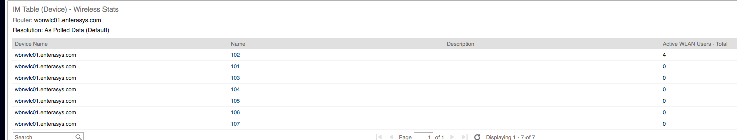

CA PM is recognizing all of my configuration, but it seems like that the way it counts my users per SSID isnt working as expected:
for example, if i do a snmpwalk on the CLI, i get back 51 users for SSID .101
CA PM tells me for the metric "Active WLAN users Total" something like this:
anyone knows why CA PM is counting this wrong?

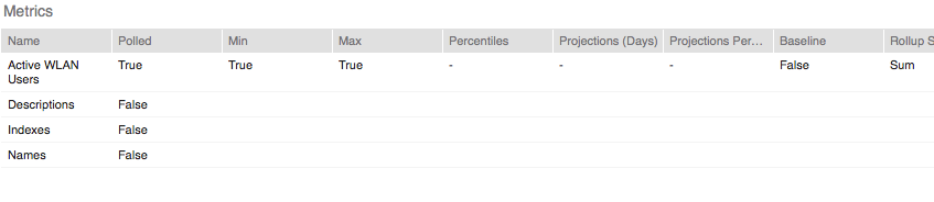

here is my defined metric:
