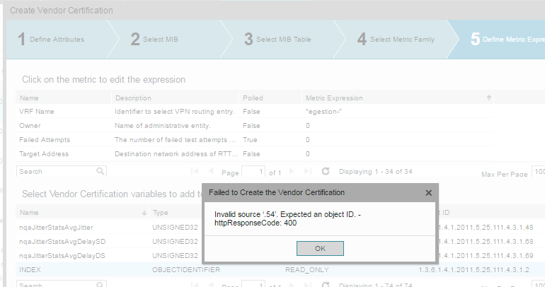

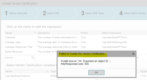

    When I try to create a Vendor Certification on CA PM in 6 step, after of set a OID to each expression. when I click on save to finish the process immediate appear a window with error messages (look imagine below):
    How can I fix this issue:

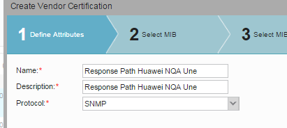

    Step 1
    filled the field either name and description.

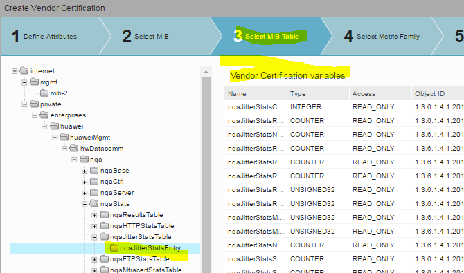

    Step 3
    I picked up OID families to get the measures of metrics. In this case NqaJitterStatsEntry.

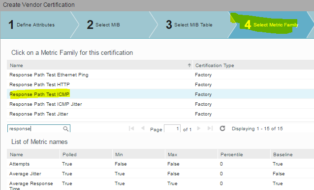

    Step 4
    I selected Response Path test ICMP. because is the metric family that have a bunch of metrics that I need collect data from diferent test of NQA of jitter, latency and packet lost.

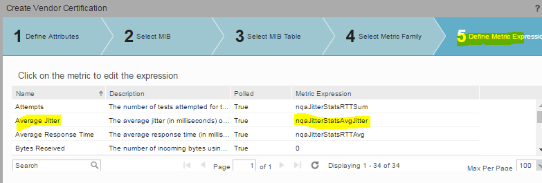

    Step 5

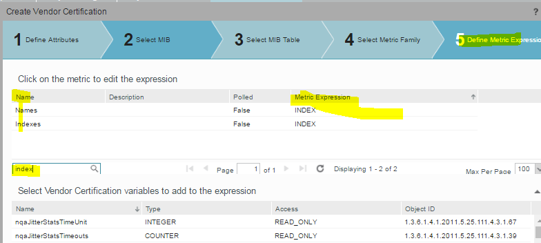

    I set the different metric expression base on the oid selected on step 2. this to collected all data of the differents OID.
    finally, I click on save to complete the process. but in that moment appears a error's message that I show in the first image that I post here.
    This is the error message that appear when I try creating a vendor certification.
    CA support say that this error happens the user don't set up a expression for the name and index metrics. But like I show in 5 step. I set up a expression for those metrics.
    • so my question is: can someone tell me how can I fix this issue? Do I lack another metric by set up a expression?

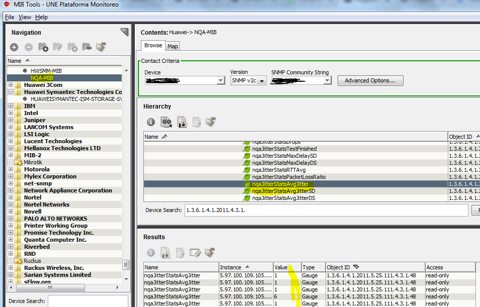

    I used mib tools to check all those oid to create this vendor certification.
    __________________________________
    OID:1.3.6.1.4.1.2011.5.25.111.4.3.1
    Router that perform all nqa test
    Quidway NE 40E-3:
    Huawei Versatile Routing Platform Software
    VRP (R) software, Version 5.150 (NE40E&80E V600R007C00SPC300)
    Copyright (C) 2000-2013 Huawei Technologies Co., Ltd.
    HUAWEI NE40E-X3
