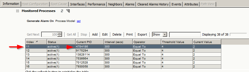

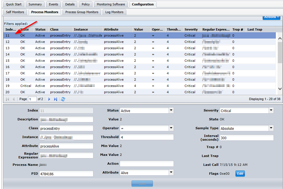

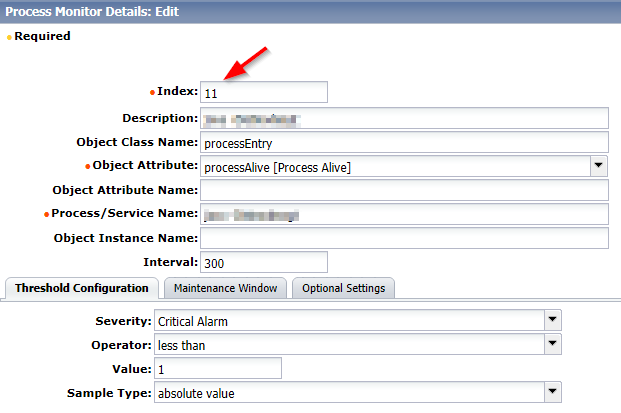

    I'm going to attach some screen captures and step-by-step explanations.... hoping it will help clarify my problem.
    1)  Starting with VAIM --> Configure --> Policy --> Monitoring Templates --> SystemEDGE --> Unix --> Server Template:
    In the Proceess Monitor Details: Edit, I would change the Operator value to "less than", Value to 1.
    After which, I would apply the Template to the appropriate server.
    2)  In VAIM --> Explore --> Managed --> Server Name, then Configuration tab --> Process Monitors tab:
    In the chosen Process Monitors tab, VAIM will show the values.
    The shown values shows a different Operator value than what was set in the Template, along with the Threshold value.
    3)  In Spectrum, under the server in Information.  The Operator values are also not what is shown in the template.

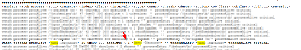

    4) BUT when I view the policy file from VAIM --> Explore --> Managed --> Server Name, right-click Server Name --> Policy --> SystemEDGE --> View Policy Configuration:
    In the configuration file it shows the correct set values in the Template.
