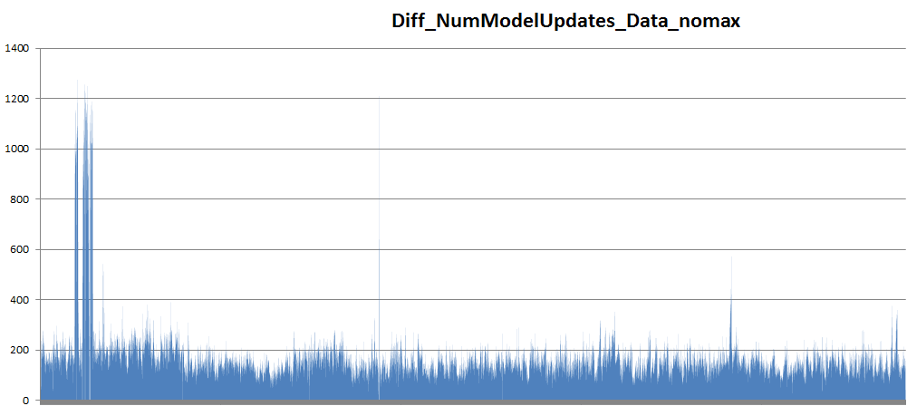

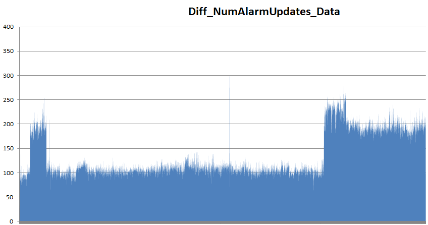

    Here - by default the OC-server is configured to connect to the MLS to retrieve the Lanscape Map info covering all the Landscapes/SpectroSERVERs (and we saw sometimes using a different configuration via context.xml - locServerName parameter) - and that "info" is used for the OC-service to write performance event records to the SSPerformance applciation model. The performance events 0x4820002 will cover counters from OC-server startup time increasing per 1 minute interval. Exporting these and processing i.e. via Excel macros will allow to see "workload characteristic" for the OC-server - and if that is affected by significant changes at modeling / monitoring level. Find below weekly graphs for model- and alarm-updates per minute. Processing limits "per minute" will depend on active OC-Console logon and the "hardware" for the OC-server (here multi-threaded/core system) - plus the "network performance" between OC-server and OC-Console. Critical values are > 10k/minute and would require specific analysis.
