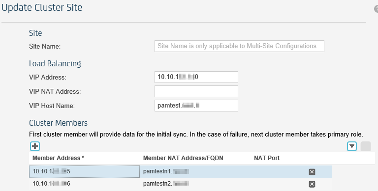

    Hi to all... I've configured my cluster PAM, version 3.1.1 with 2 members:

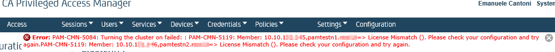

    when I turn ON Cluster this message return:
    (Error: PAM-CMN-5084: Turning the cluster on failed: : PAM-CMN-5119: Member: 10.10.1XX.XX5,pamtestn1.XXXX.XX=> License Mismatch (). Please check your configuration and try again.PAM-CMN-5119: Member: 10.10.1XX.XX6,pamtestn2.XXXX.XX=> License Mismatch (). Please check your configuration and try again)
    Below the license information:
    if I remove the FQDN from the cluster configuration the cluster come UP and all work fine... but I need that the cluster balance on FQDN...
    in another PAM with the same configuration this work fine... is there any limit on FQDN composition?

    Hi Emanuele, This suggests that the master node was not able to retrieve the license from the second node. Is it possible that the FQDN you added cannot be resolved by the first node, or maybe doesn't resolve to the correct IP? You can use the Devices > Tools page to check on name resolution.
