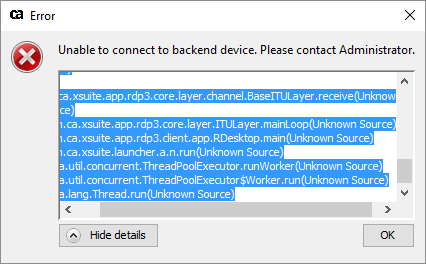

    Second is if we leave a RDP session open for a few days, let's say 2 days (starting friday) when we arrive on monday the connections were lost with following errors:
    Error RDP connection.
    Logs inside box:
    Error type: RdpException.
    Error message: Unable to connect to backend device. Please contact Administrator..
    Stack trace:
       com.ca.xsuite.app.rdp3.client.handler.TCPStreamHandler.read(Unknown Source)
       com.ca.xsuite.app.rdp3.core.layer.channel.BaseITULayer.receive(Unknown Source)
       com.ca.xsuite.app.rdp3.core.layer.ITULayer.mainLoop(Unknown Source)
       com.ca.xsuite.app.rdp3.client.app.RDesktop.main(Unknown Source)
       com.ca.xsuite.launcher.a.n.run(Unknown Source)
       java.util.concurrent.ThreadPoolExecutor.runWorker(Unknown Source)
       java.util.concurrent.ThreadPoolExecutor$Worker.run(Unknown Source)
       java.lang.Thread.run(Unknown Source)
    Cause:
    Error type: EOFException.
    Error message: .
    Stack trace:
       com.ca.xsuite.app.rdp3.core.impl.RDPInputStream.readFully(Unknown Source)

    Hello Ellery,
    I did a small test with Windows 10, and I am connecting to this host using the in build Administrator account.
    The RDP happens fine, and after almost 18 to 20 minutes of inactivity on the Windows 10 host, I see the following error message..
    Error message: This computer can not connect to the remote computer.
    Try connecting again. If the problem continues, contact the owner of the remote computer or your network administrator..
    Stack trace:
    Cause:
    Error type: IOException.
    Error message: Internal TLS error, this could be an attack.
    Stack trace:
    com.ca.xsuite.app.rdp3.core.common.libs.org.bouncycastle.crypto.tls.TlsProtocol.failWithError(Unknown Source)
    com.ca.xsuite.app.rdp3.core.common.libs.org.bouncycastle.crypto.tls.TlsProtocol.safeReadRecord(Unknown Source)
    com.ca.xsuite.app.rdp3.core.common.libs.org.bouncycastle.crypto.tls.TlsProtocol.readApplicationData(Unknown Source)
    com.ca.xsuite.app.rdp3.core.common.libs.org.bouncycastle.crypto.tls.TlsInputStream.read(Unknown Source)
    com.ca.xsuite.app.rdp3.core.impl.TLS12InputStream.readFully(Unknown Source)
    Along with the error message one more small pop-up window shows this message
    This pop-up is basically hidden under the mail error message.
    I am as well using R 2.6 PAM version.
    Thanks,
    Reatesh.
